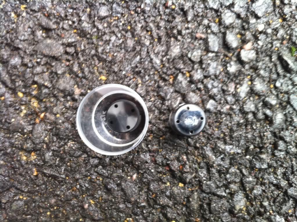

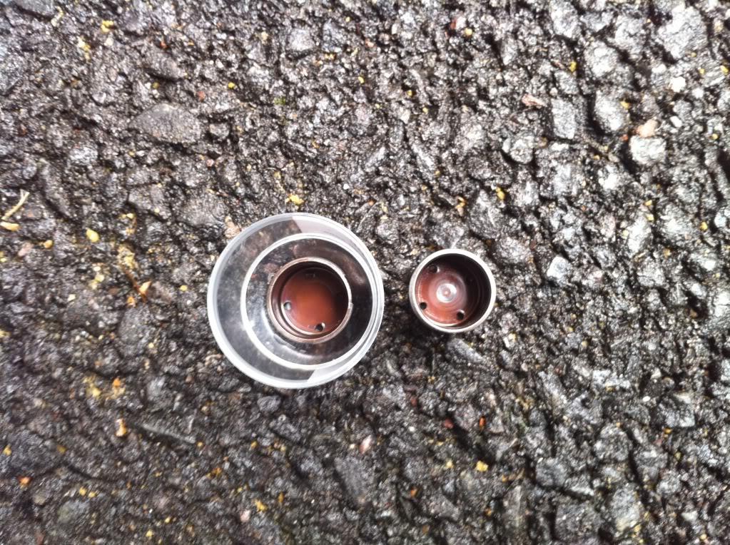

For one reason or another i actually forgot about doing this since the last change  :surprised: (getting married etc  :smiley:)
I bought 2 cam followers last time so had a spare sat in the Garage. However for the last 28k miles it hasn't been changed  :ashamed:
After a gentle reminder with a thread put on here today linking my tutorial i thought i'd nip out and get mine swapped over.
I took some pics to show what the wear is like on a Mar 2007 TFSi engine. I kept the new one in the pot whilst changing the pics just so i didn't get it dirty.

Quite similar wear pattern to mine after about 15k miles. I'm just not hearing about the 'horror of Autotech HPFP internals' from any source any more but probably won't leave it to 28k myself :wink:

I wouldn't do normally myself Dave and i will be ordering a new one tomorrow so i have a spare.
I just forgot as i haven't been using the car as much and i can't expect the wife to do it  :laugh: :laugh:

« Reply #5 on: August 10, 2010, 04:42:03 pm »
This was my follower after around 31k.
Still had plenty of life left in it but I changed it anyway.

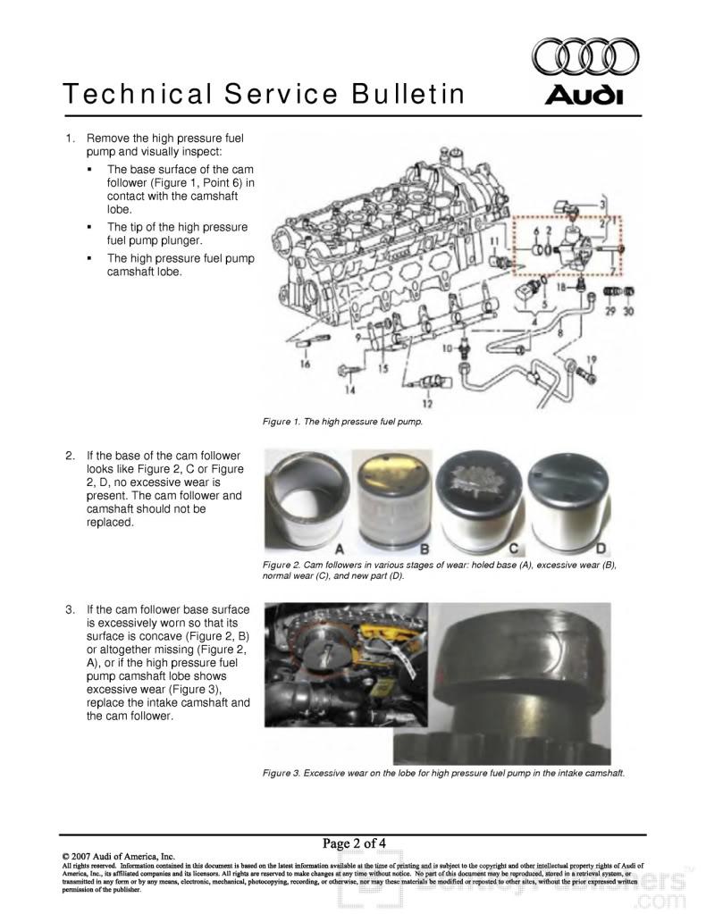

This is an extract from an Audi TSB. If you read through it says that the wear indicated by mine and others Cam Followers doesn't need changing. But i always do mine for peace of mind. £25 for new Cam Follower or about £1k for new camshaft. Makes sense to me :smiley:
