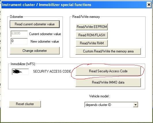

« Reply #37 on: September 01, 2010, 11:27:26 pm »
Hiya Darren mate,
We only tried it a few times but got this error;
When reading the mileage it read it fine.
Then when clicking 'Read Security Access Code' for my old dash it worked fine (960 version midline)
When I had the new dash in, it just came up when I tried to read it;
"Security access code not found!Reset instrument cluster and try again"
I tried that, it made no difference :( Maybe they stuck the IMMO4 in a few earlier 972's?

« Reply #38 on: September 01, 2010, 11:37:18 pm »
you havn't got the right vag commander, i kept getting that with mine?  it needs to be a specific programme i think its some think like vag commander k+can 1.4 once i had this new program it took 2 minutes to swap over
Darren

« Reply #39 on: September 01, 2010, 11:39:10 pm »
Im trying to check on the screenshot, don't forget he's one of the Leon Cupra crew so he's probably deliberately told me I couldn't do it  :grin:
Screenshot says;
VAG-K+CAN COMMANDER FULL 1.4(CHINA)

« Reply #42 on: September 01, 2010, 11:44:56 pm »
Screenshot says;
If its the right one you should have a button that says read/write immo then when you go into that you need to read the immob data ...then in the bottom corner the skc code can be seen.

« Reply #44 on: September 01, 2010, 11:51:45 pm »
Darren,
This is the screenshot of what it was;
I wasn't clicking in read/write immo, I was only clicking 'read security access code' as thats what the VWVortex guide had said to do?
And thats what I had clicked to get the code from the midline dash I had, and it worked?  Was I doin it wrong then?
