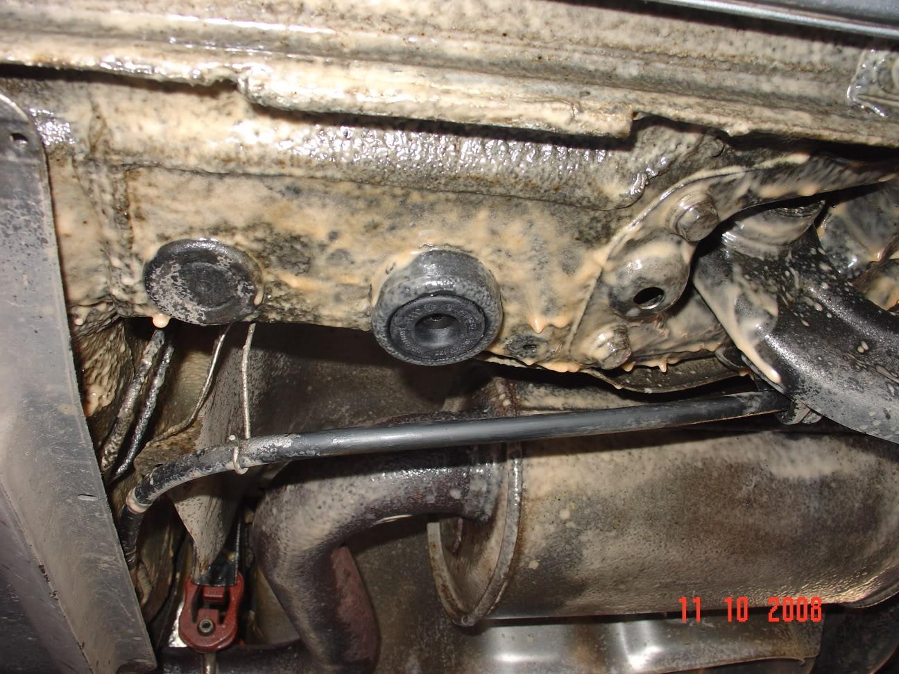

That was my Waxoyl!  That is just an anti rust protector, it dries to a thin clear seal, and actually is really good stuff.
BTW, has anyone else noticed that Waxoyl has gone a little erm, GAY.  My latest batch was PINK!
