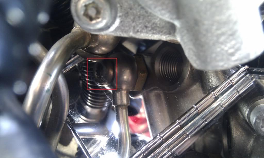

I have now hooked up a light and can see I need a star shaped tool for the bottom of the banjo bolt.
Anyone know what this is and what size I need? Looks like a T50????
What you are looking at here is a mirror reflection under the bolt.
Help!

Its a spline fitting not Torx. I can't remember the size of it though.  :ashamed:
Yours must be an early car.

It's an my06 car :happy2:
Come to think of it it does look more like a spline. Any ideas of the size anyone?

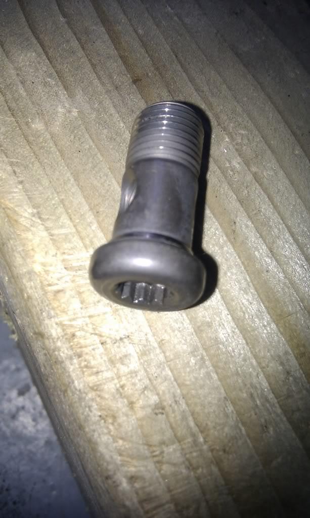

From memory it's a M10 Spline but don't quote me as i have only seen it once before about 2 years ago.
Edit - ETKA lists the part as an M10X1 Banto Bolt. :happy2:

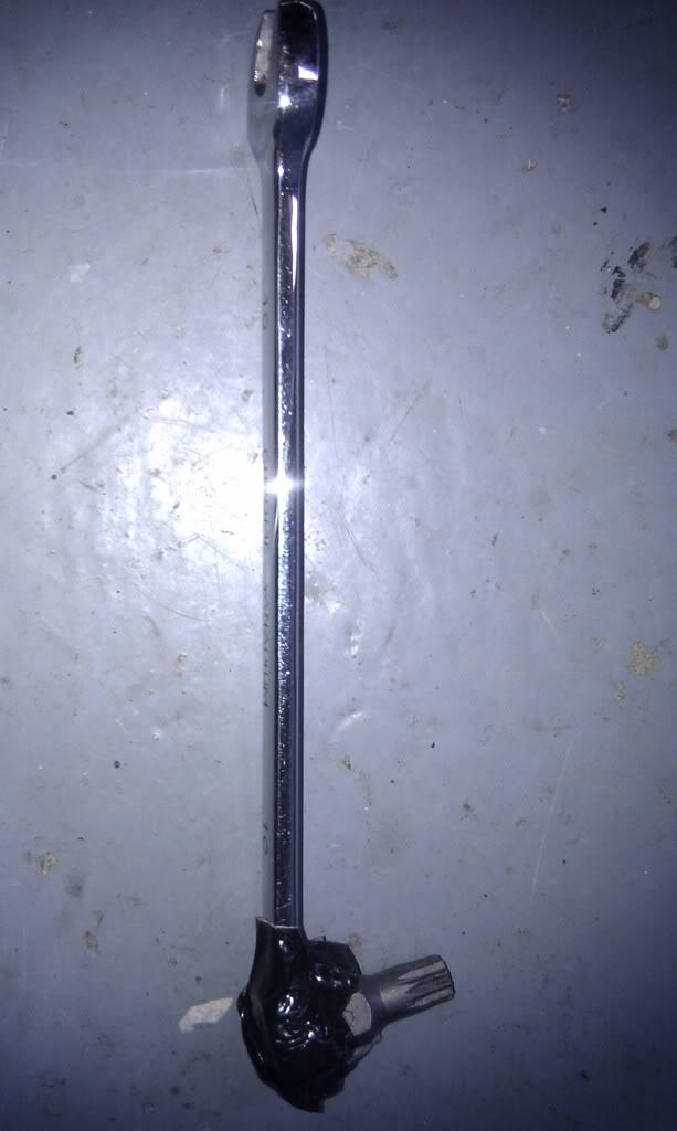

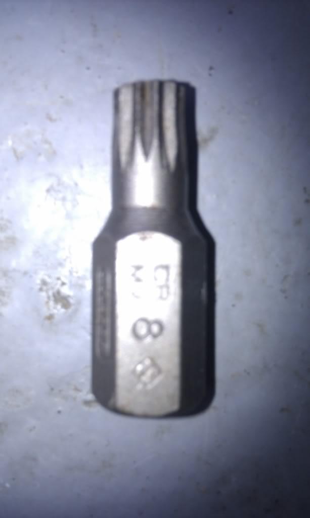

Firstly the tool I used to undo the splined bolt
This is an M8 Spline used to undo this
You can't get a ratchet in due to space restrictions so I taped it to a spanner (to stop me dropping it for the second time) :grin:

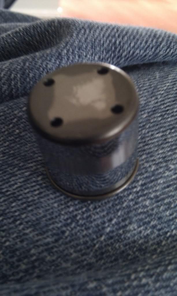

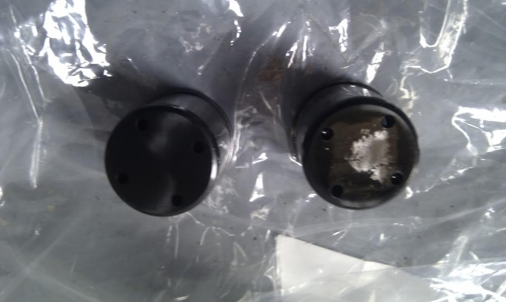

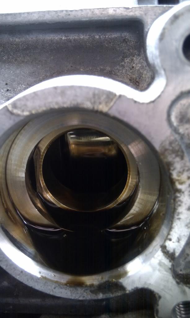

There doesn't seem to be much wear on the lob of the cam (thank god). But the same cannot be said of the follower. :surprised:
This is the comparison of old and new. Notice the coating is worn away and the bare metal is showing. The Technical Service Bulletin states that "rapid wear will occur" at this stage.
And a side view.
The close up shows that the wear has been enough to start to give concern. It has never been changed on my car and that wear is on a MY06 with 40K. I am so glad I changed it despite the problems I had fitting it. It's like any job, the next time I come to do it it should take me half the time. One thing that did surprise me is the effort I had to give to put the pump back on and overcome the spring. I was really careful not to cross thread or overtighten any of the bolts and I have checked the pipes three times since driving to make sure there are no leaks. You can do this without taking the engine cover off by peering behind the cover.
