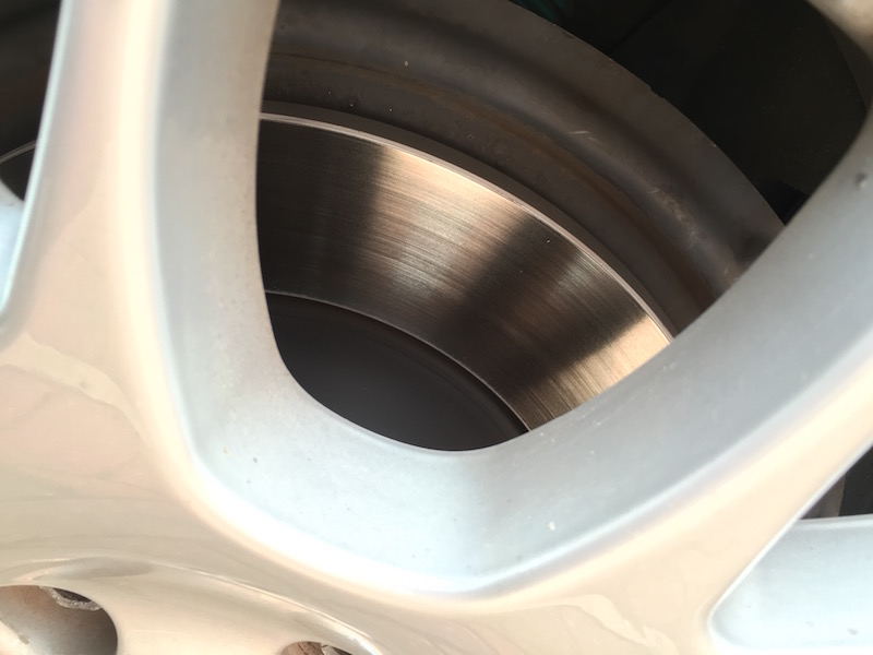

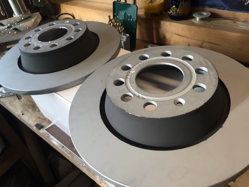

Rear disc barrels painted in high temp paint.
Offline Shoduchi
  • -Given: 220
  • -Receive: 430
  • Posts: 4173
Re: rich83 - Edition 30 Cam Chain Done!
« Reply #2391 on: May 17, 2016, 07:43:47 pm »
They look very nice! :happy2:
dansmith180
« Reply #2392 on: May 17, 2016, 08:11:07 pm »
Always a nice touch to stop them going bloddy orange. You should do the face of the disc as well so it matches  :happy2:

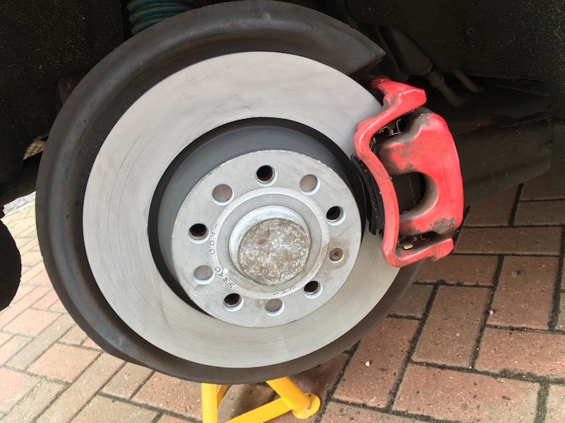

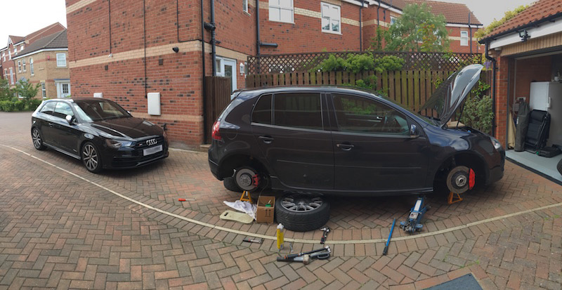

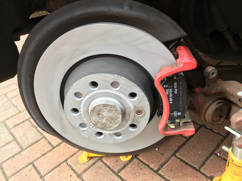

Re: rich83 - Edition 30 Rear Brakes
« Reply #2396 on: May 20, 2016, 12:22:56 pm »

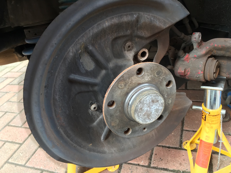

A bit of progress.

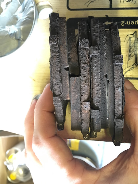

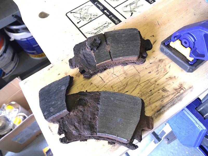

Pads were f*cked.... not good. Brembo HP Sport
Not much room to get the wrench in (yes I know you shouldnt use a torque wrench to undo bolts)
Just go the change the brake fluid and bleed them properly.

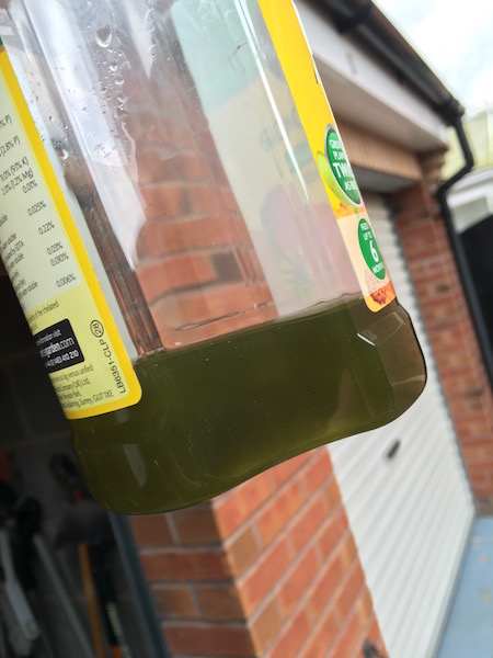

Fluid out of the reservoir

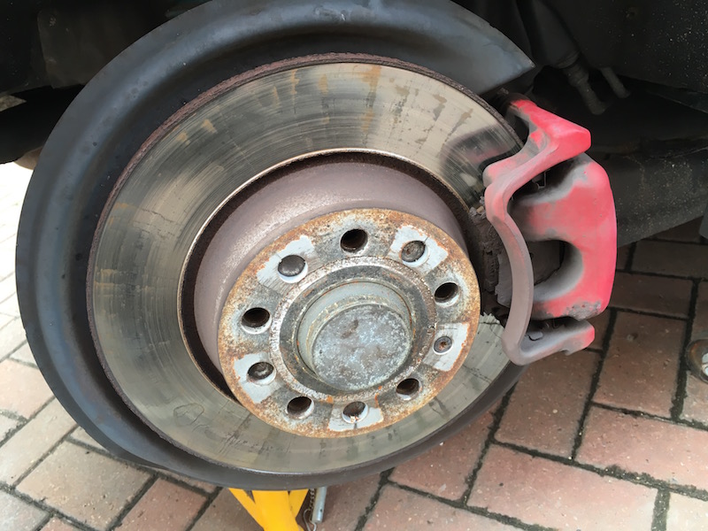

Went for a little drive. The brake pedal does seem a bit firmer than before, which has given them a nicer "bite"

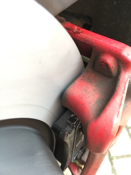

Pads sweep the entire surface of the 282mm discs, so no lip will form.

That fluid is very dark for a vehicle which gets such TLC Rich, how long since its been changed and are you removing the pre filter on the reservoir?
