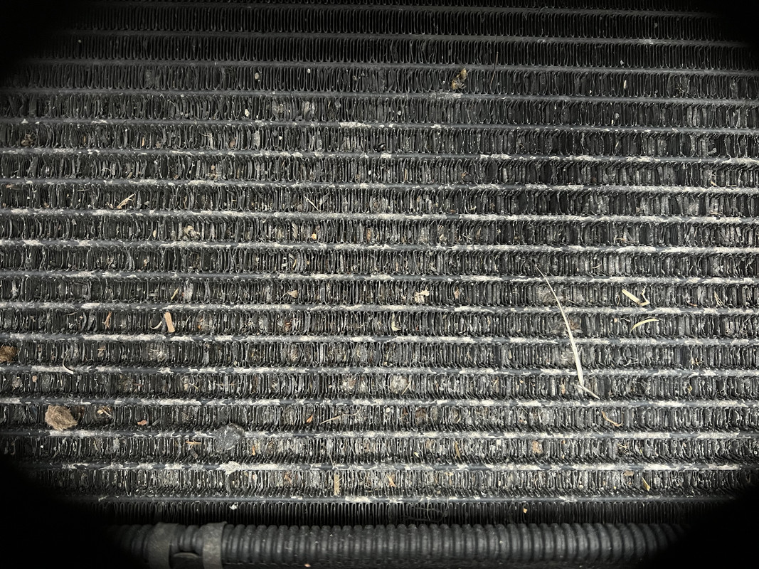

Wow, that’s taken a beating.  :scared:  I can see the fins on mine are all smashed in but as far as I can see there are no gaping holes in it  :signLOL:
Aye, and those folded over, mangled fins partially block the intercooler  :grin:
Re: rich83 - Edition 30..... 9 Years
« Reply #2543 on: April 08, 2022, 02:23:32 pm »
Of course... and I am almost certain this is why when its really hot (like it was last year) my water temp creeps up in stationary traffic with the a/c on.
« Reply #2544 on: April 08, 2022, 03:46:09 pm »
And yes that is a stone wedged in bottom left

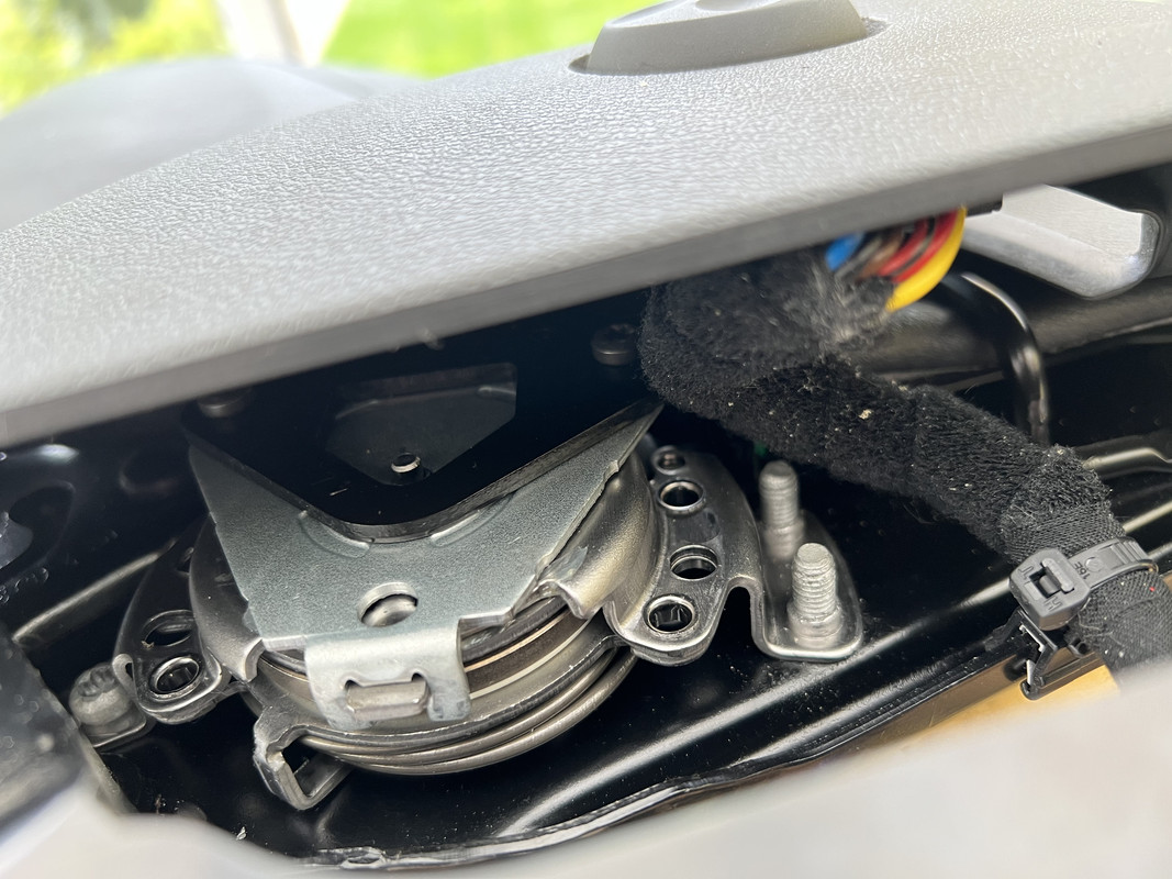

« Reply #2546 on: April 13, 2022, 11:51:47 am »
Well that wasn't such a hard job. Awkward getting to a few bolts and had to tap the holes for the actual handle because they were just drilled.

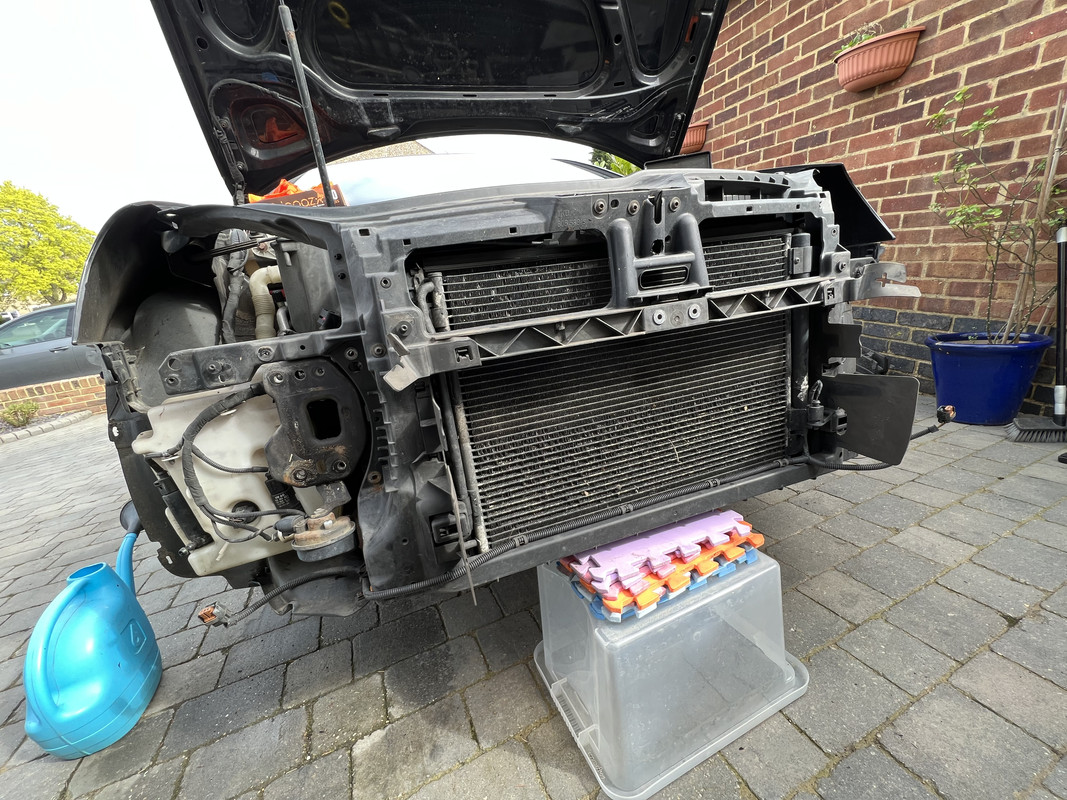

Todays job a bit more involved.

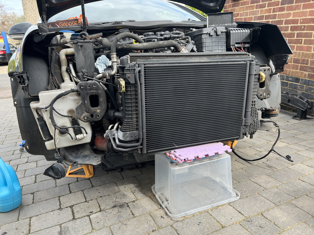

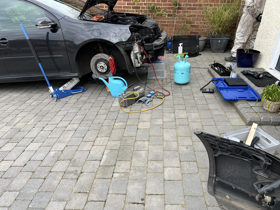

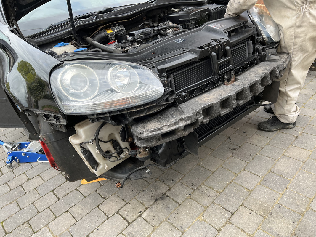

« Reply #2549 on: April 14, 2022, 04:54:19 pm »
Well that was a bit of an arse of a job. Not overly complicated just time consuming.
The nissens condenser is at best an "OK" fit. It required a fair bit of manipulation to get the lower bracket to match up correctly.
