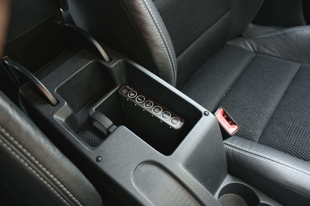

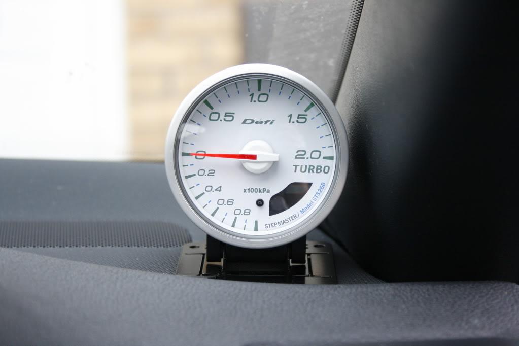

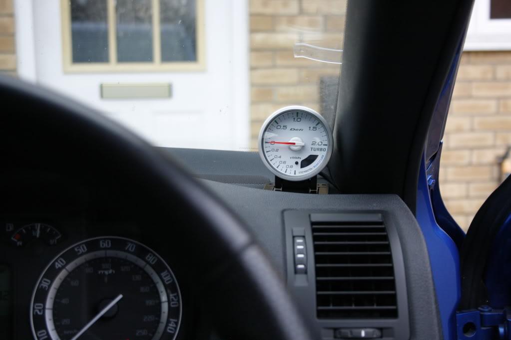

Little update.  Finally got round to fitting my Defi boost gauge.  Took me ages to work out where was best for the contoller, but it ended up in the armrest.  Pain to get all the wires to it, but worth it in the end as I can use it while driving if needed.  I have mounted the gauge on the dash for now until I can workout somewhere better.  I usually manage to install gauges in a stealth location, but the octavia has got the better of me.  Trouble is its a 60mm gauge so a no no in the air vent.  I think I will buy an a pillar trim and make a housing on the trim.
Peak boost on the Revo 2+ is just under 1.8 bar.

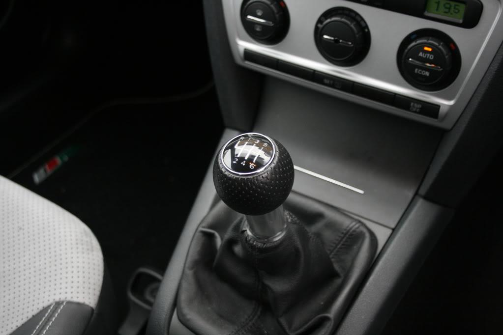

I fitted an Audi S-Line gear knob a while back too:

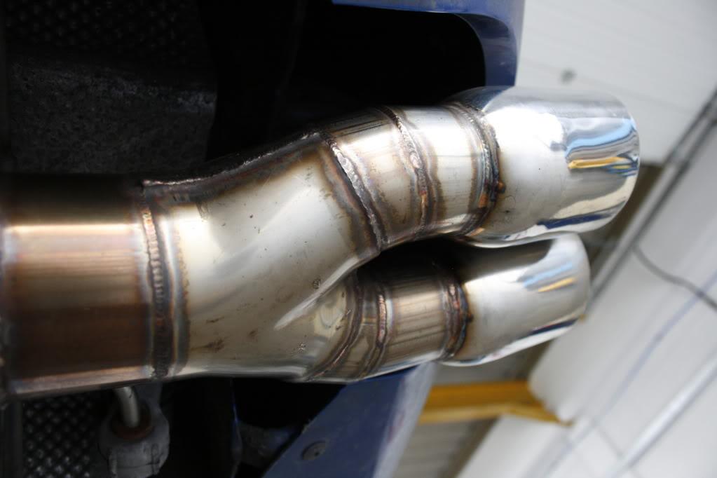

My Blueflame came without any tailpipe as per my request as they only do a 6x4 oval.  So I got my weld on and made my own:
If anyone is wondering about Blueflame at the moment, they have closed the business and are reopening soon as 'Tube Technologies' but keeing the Blueflame name too.  Hopefully they will get their act together too!  :evilgrin:

Can you not get a pod mount that fits behind the steering wheel and is a replacement for the trim?

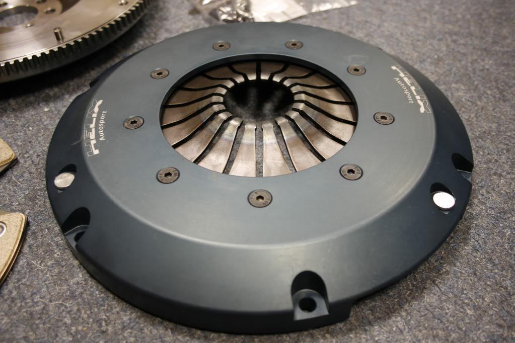

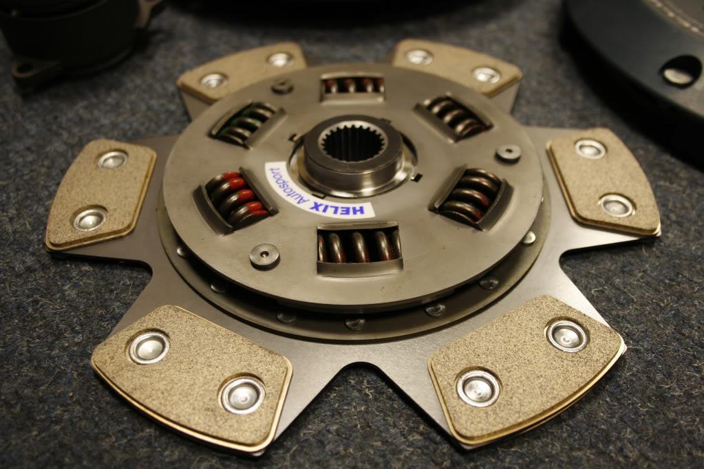

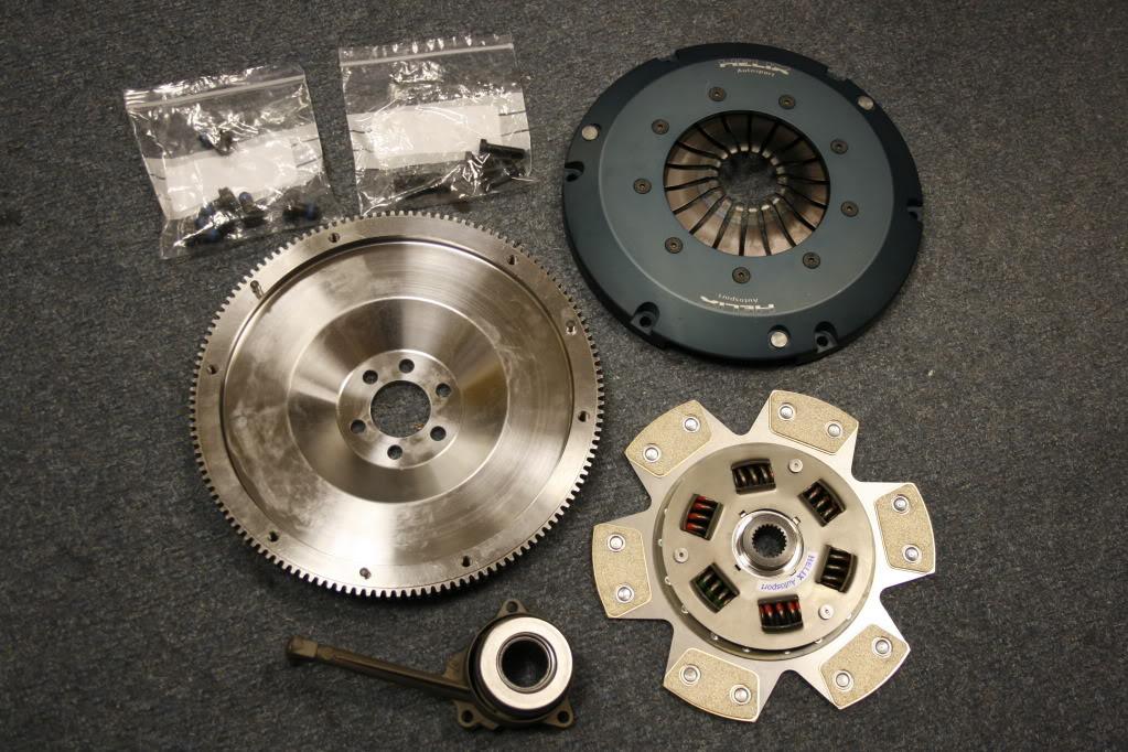

Picked up a clutch from Helix.  Single mass lightened flywheel, 6 paddle drive plate and high torque cover.  Now I can get it fitted with the diff next week.

How come you went for the Helix + SMF Alex over the seemingly more popular Sachs + DMF combo?
« Last Edit: November 05, 2010, 01:23:01 pm by KRL »
Offline vRSAlex
  • -Receive: 253
  • Posts: 2761
Re: BDMAlex's Octavia vRS Estate
« Reply #44 on: November 05, 2010, 01:26:08 pm »
How come you went for the Helix + SMF Alex over the more seemingly more popular Sachs + DMF combo?
I think its only more popular as not as many people have heard of Helix.  I only go for products that I trust from experience of fitting and using.  I hate the feel of Sachs clutches with their heavy pedal and strange bite points.  The dual mass is very heavy and doesnt help with fast reving and turbo spool up etc, plus they fail which you dont have to worry about with the single mass flywheels.
Ive fitted loads of Helix clutches over the years and they always perform very well with the pedal feeling much like standard, even with the paddle version.  Always had great feed back from customers too.
