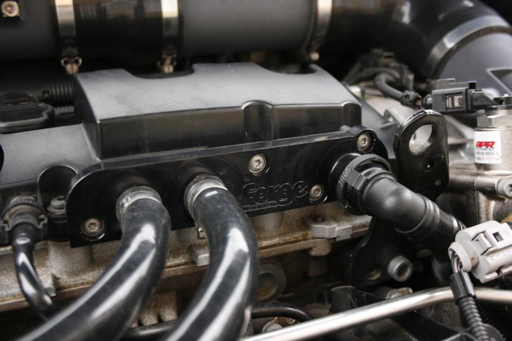

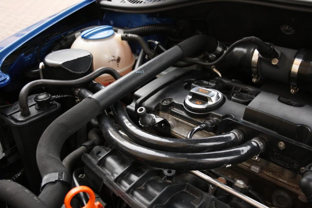

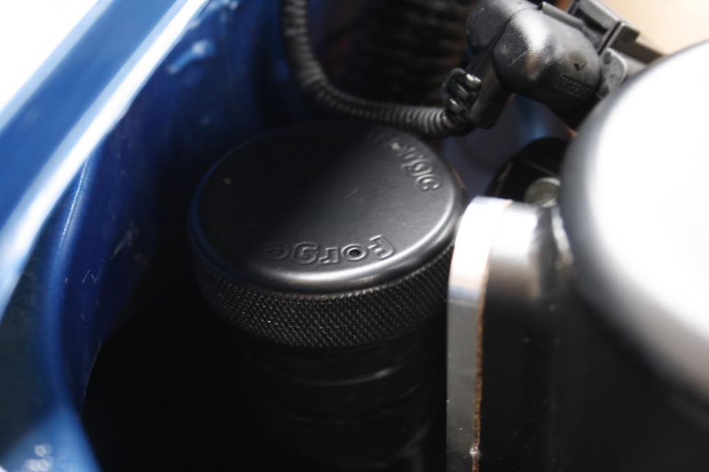

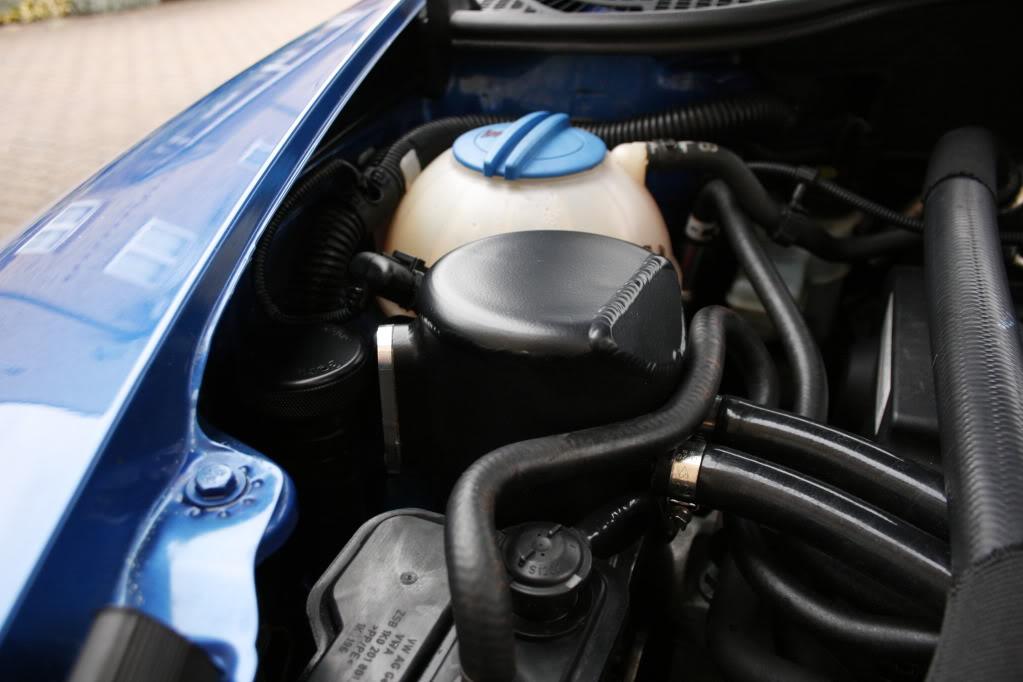

Before Xmas I fitted a Forge catch tank.  Meant for the Golf hence the sighting window being in an awkward place.  Already drained the thing 3 times as they like to fill with moisture more than oil.

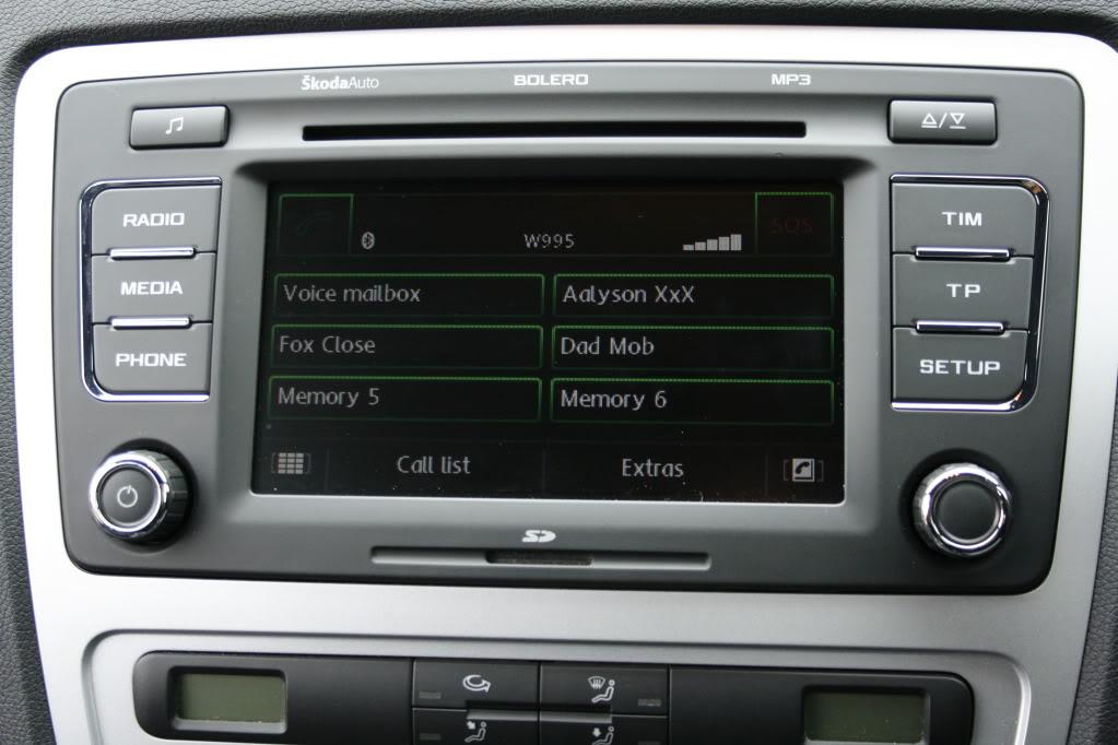

Also fitted a Bolero (RCD510) a few months back along with a Dension Gateway 5 and a new Can-Bus module

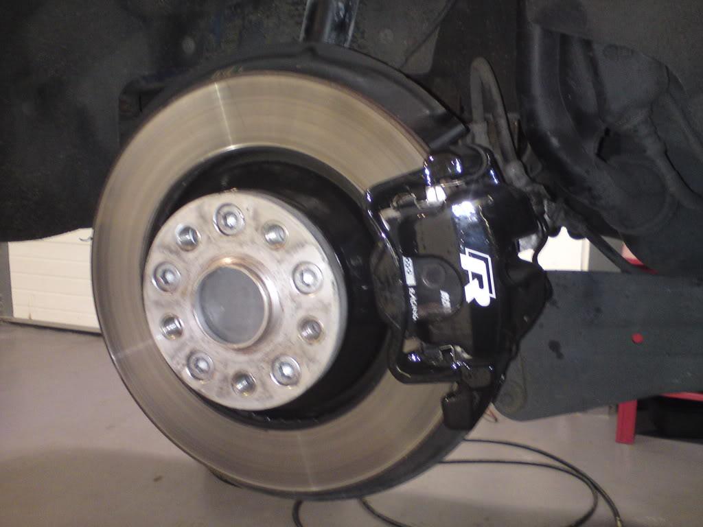

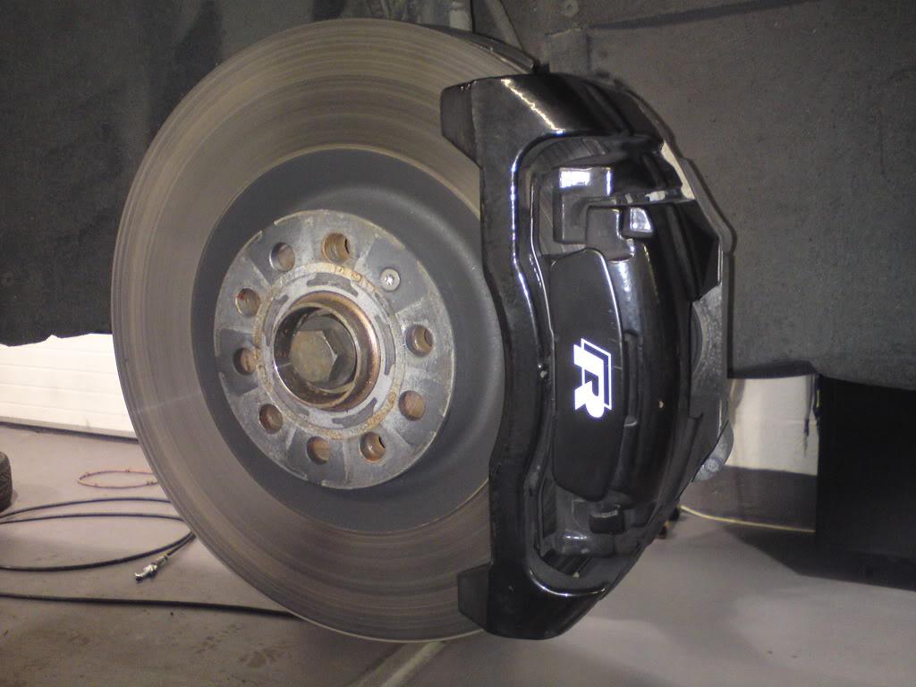

I got some R32 rear calipers and carriers from h4rdy a while back.  They needed new seals and a good clean up.  I gave them a lick of black paint to match the fronts and made an 'R' logo too.
The standard 'R' logo on the fronts is silver which doesnt stand out.  I cut some more stickers up in white to go over the silver ones (its useful having a vinyl cutter!)

How well does vinyl cope with caliper heat?

Have you got braided hoses on the r32 fronts? And if not do you want some?
