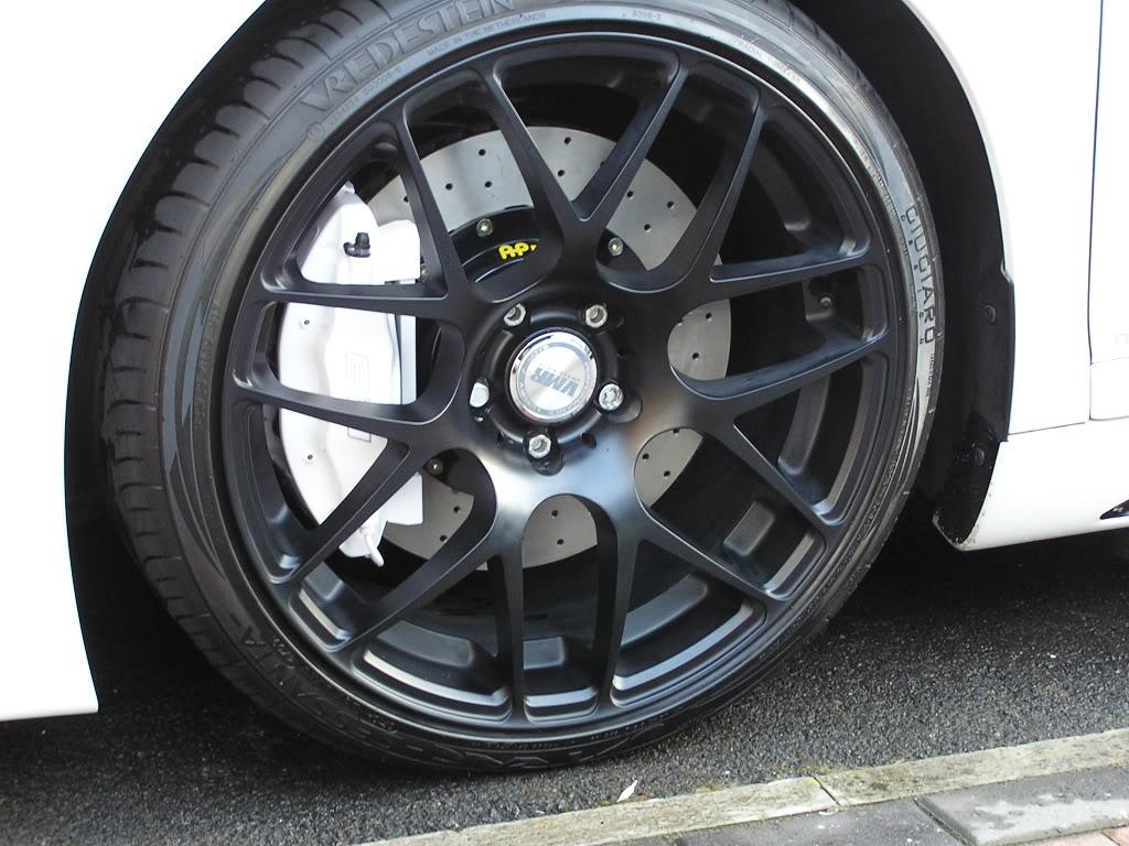

Thanks for the help as usual this site is good for assistance. I am toying with the hybrid route, would the turbo still need modding to fit the manifold if so? I have included a cple of pics to keep you happy Ron.
