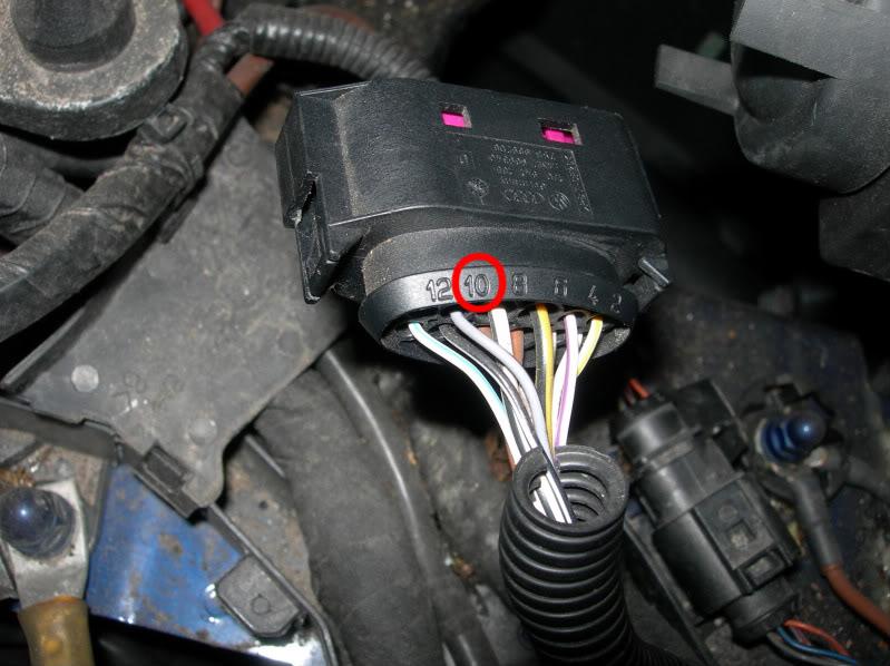

Got the drl's wired and working, as per the instructions and your details on this thread,only thing is the drls are not dimming when the sidelights or headlights are on, is there something else needs to be done, or have I missed something?
regards, Paul.

without checking in detail sounds like you need to wire up the dimmer this would probably go to the headlight power wire or something.

« Reply #280 on: March 30, 2014, 09:18:44 pm »
Hi PND,
regards, Paul.
Quote
black wire      : connect to ground (ended up fastening to chassis ground (blue nut in right of next picture)
white wire      : trigger to 'dim' - connect to pin10 on back of headlight connector (circled in next picture)
red wire        : connect to switched live (12v ignition) - connected to spare switched live in fusebox in dash
If they are lighting up but not dimming, then the control modules are not getting a signal down the white wire properly.  It needs to be joined to the wire coming from pin 10 on one of the headlight connectors (see above pic).

Hi,
I connected white wires from both drl's to no 10 on car lighting block, as per you pic. I extended the white wire to the offside drl with heavier cable than supplied, all i could find in the shed, could this cause a problem. I have tested all the connections with a meter and all seems ok. need to perhaps disconnect each drl in turn and see if one of the modules is faulty, what would your thoughts be?
Thanks again,
Paul

After 3 years, I ended up with a faulty connection / one dimmer module failing and the DRLs were permanently dimmed.  As a result of this, I reconnected everything and tried wiring both DRLs off one module and they seem to work OK like that.  I connected a single white wire to pin 10 and used one dimmer module.  I just took a feed from each output wire going to one DRL and took them across to the other DRL.
You need to check that you are getting a voltage out of pin10 when the lights are on and also that using the original white wire, you are getting this voltage at the dimmer module end.  If you the module is working, it should then output a reduced voltage to the DRL.  You'll have to check each bit in turn and see where you get to.
If you think you've got a failed dimmer module, either contact where you got them from or try emailing this chap in Germany, they are the european distributors.  That is assuming you've got the JOM product and it looks exactly the same as mine!
