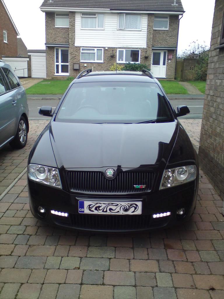

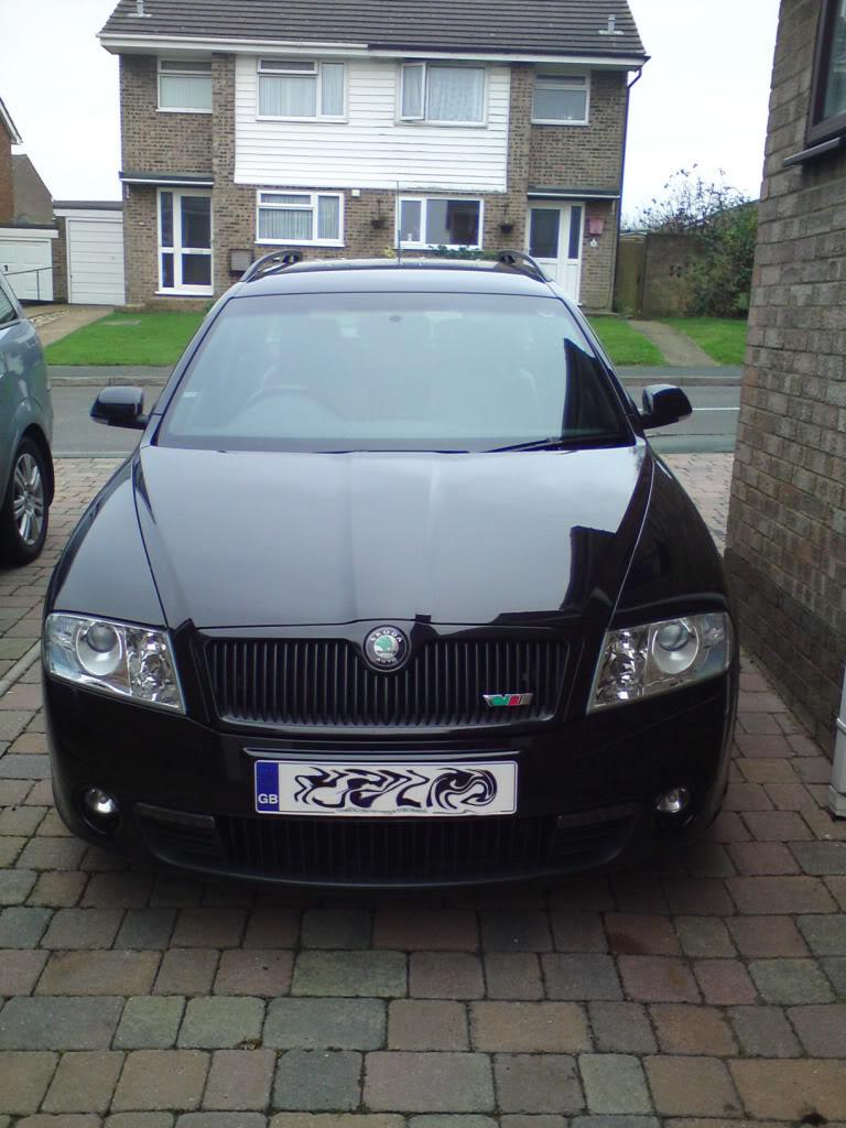

Welcome along Pete, this may help with your decision, although fitted to my vRS, I wrapped my retrofitted DRL's in Lamin-X smoke tint.  When off they are hardly noticeable, but the film makes little or no difference to the light output when they are on.....

That's great, that's exactly the look I am going for. Thanks. I've ordered a pair I'll post up when I get them fitted. Thanks.

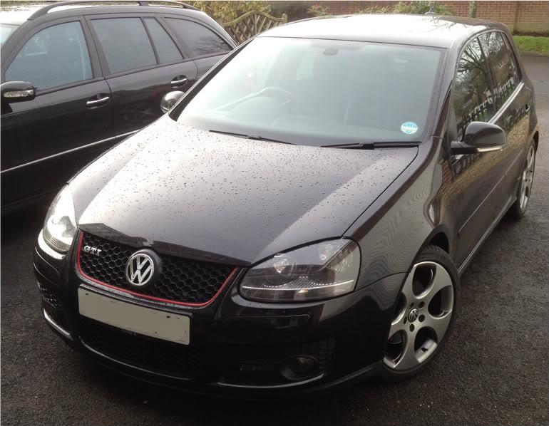

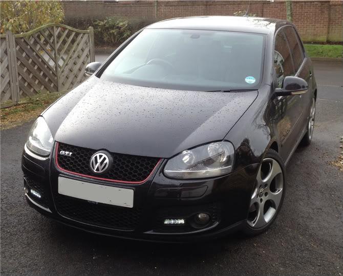

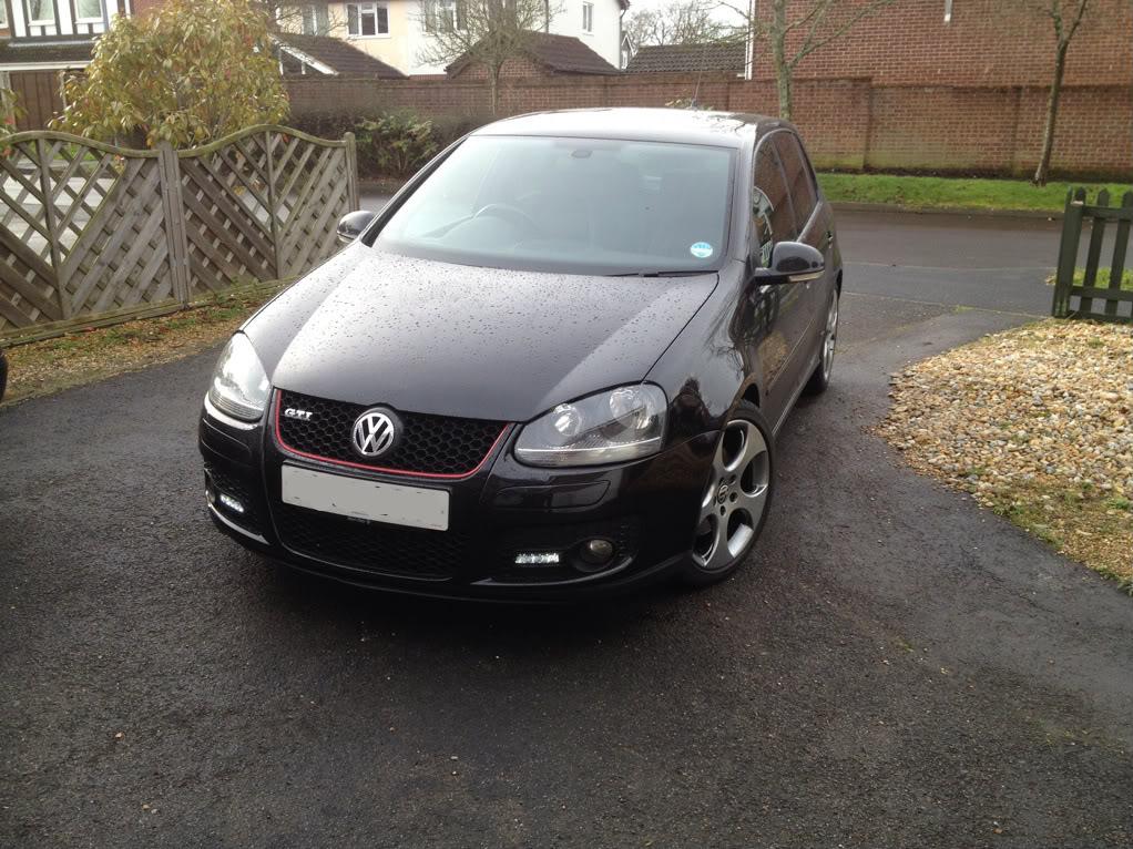

and here they are. Glad I went with smoked

« Reply #248 on: January 19, 2012, 06:48:25 pm »
Welcome aboard!! I think that's 3 of us now!
Looks really good.  :happy2:
