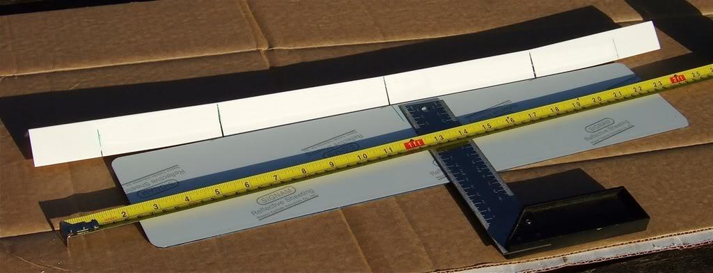

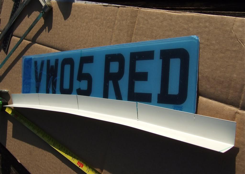

I bought a length of plastic angle and sawed cuts in one side so it could bend : -
^ Basically I was making a 'shelf' to position the number plate in line with the bottom of the nose mask.

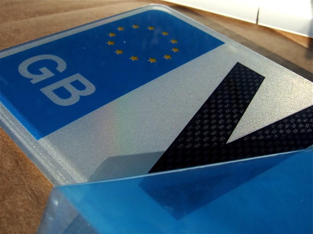

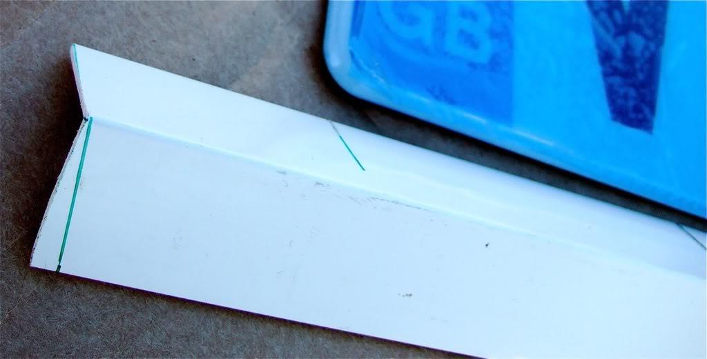

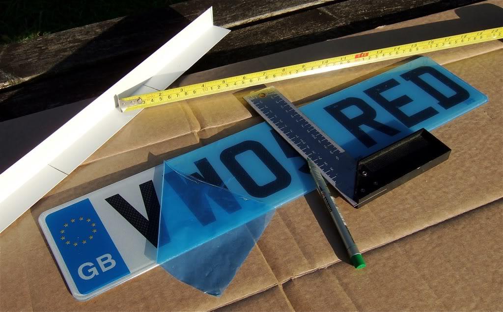

To be able to position the plate centrally I marked both the plate, front and back, and the plastic 'shelf' : -

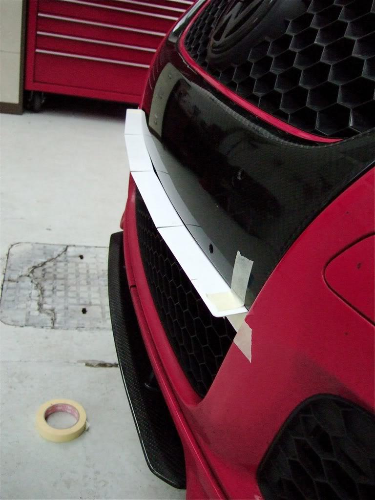

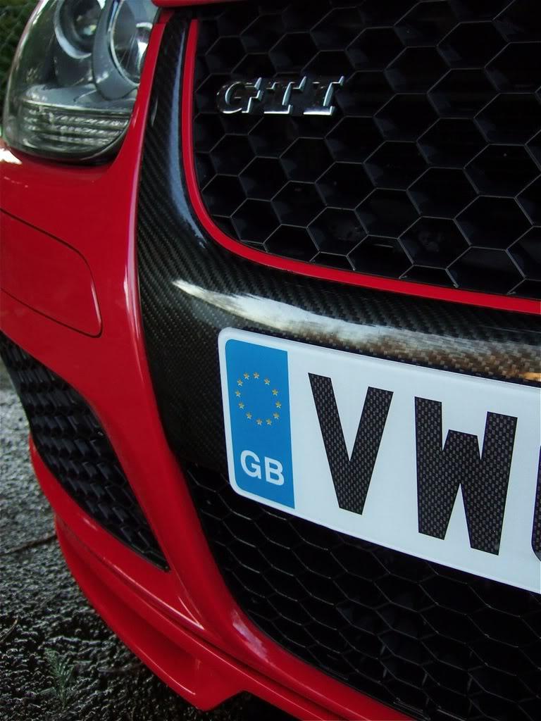

To fit the angled lower grill I also marked and cut the uncut side of the plastic 'shelf' : -

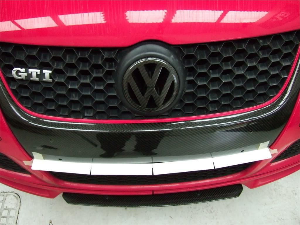

It was now time to stick the double-sided sticky pads to the back of the number plate : -

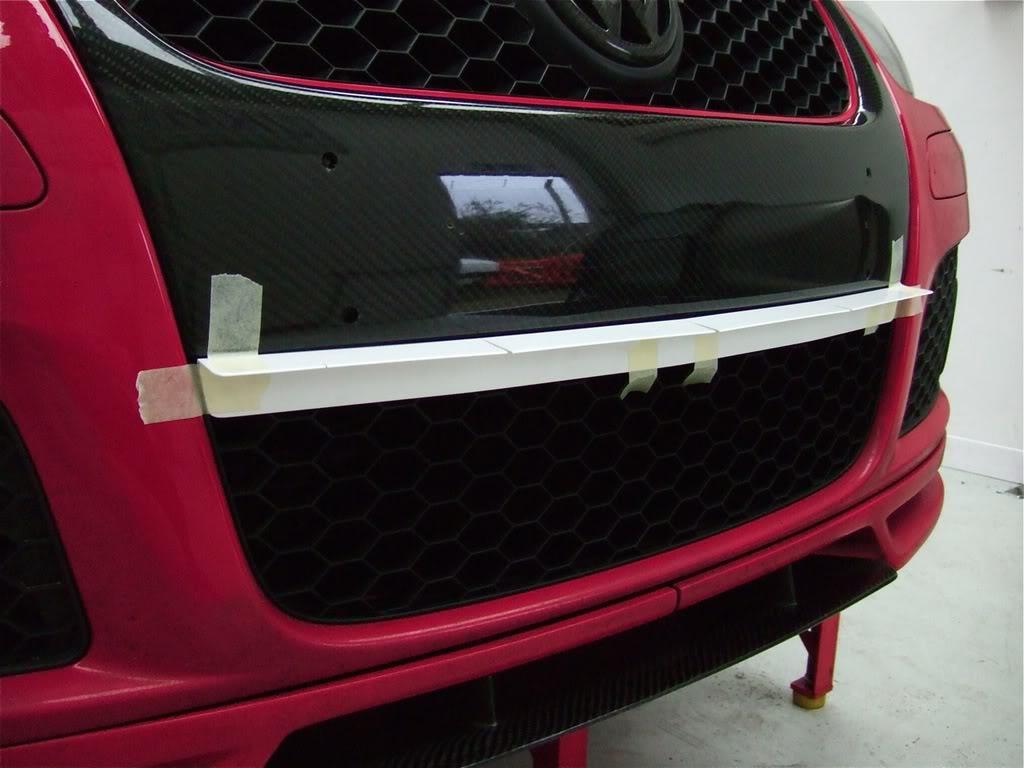

The shelf was attached with masking tape and it was time to finish the job : -

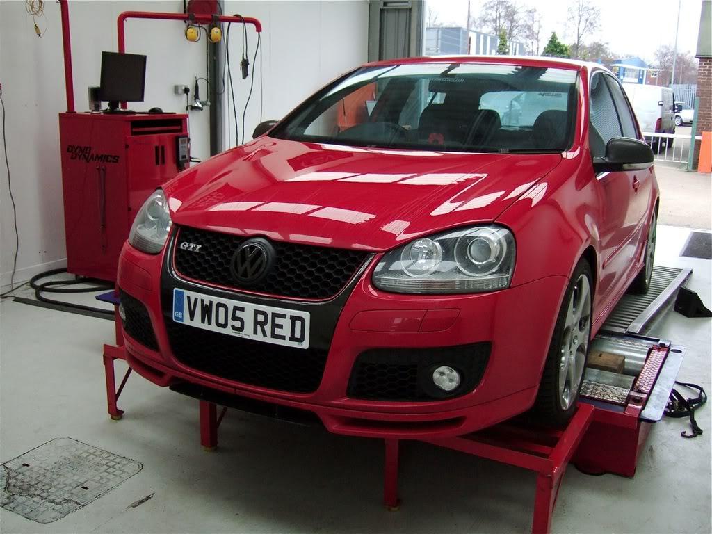

JKM very kindly allowed me to use their rolling-road as a ramp so I wasn't crawling all over the floor : -
I never liked the fact that the oem mounted plate dropped below the mask and slightly in front of the lower honeycombe grill.
Personally I don't want to take any risks on the legality of my plates both in the UK and Europe.
