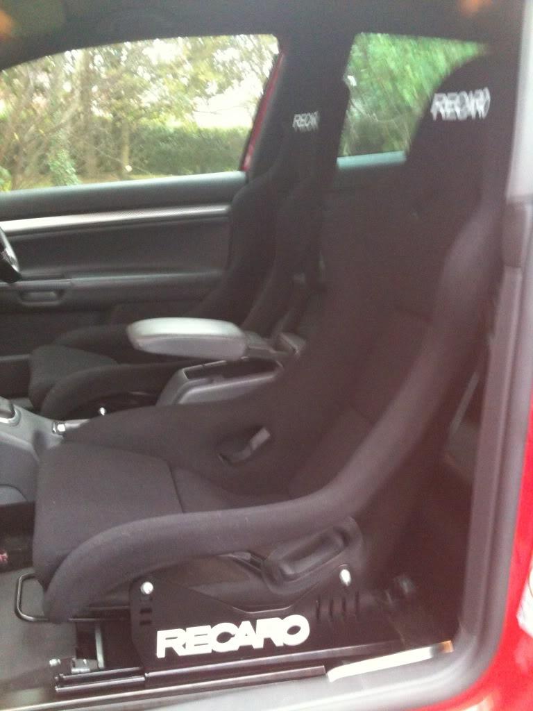

« Reply #24 on: November 05, 2010, 02:04:29 pm »
Lets get to the crux of the matter................
 :worthless:
bad photo quality :)

Re: fitting recaro pole positions into my mk5
« Reply #25 on: November 05, 2010, 02:14:15 pm »
Cool.
See the bolt holes in the sidemount, well the ones on the rear appear to only have 2 settings, but if you use a lock washer you can actually use the slider bar below them. They'll drop miles!
Sideways yo!
« Reply #28 on: November 05, 2010, 04:17:26 pm »
Those, even with poor photography, are looking cool.
I'm thinking that I would get my coachbuilder friend to do the cushion segments in Interlagos (to match my interior) and I'd carbon vinyl wrap the seat backs et voila! - Proper seats for trackdays but cool for road use.
How much are these Pole Position Recaro's?
