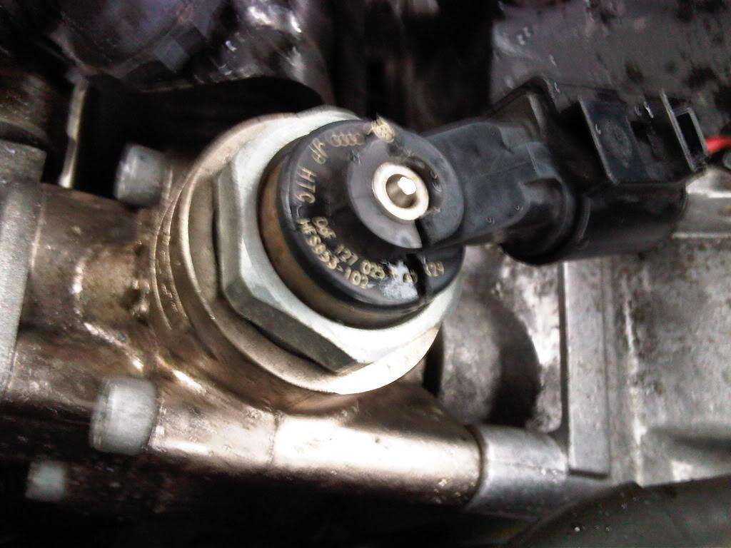

anybody know what this fault code means p2294 i cant seem to find anything other than fuel pressure sensor open circuit or bad connection

Sure its not p2293?
http://wiki.ross-tech.com/wiki/index.php/18725/P2293/008851
I have seen this a couple of times, both times was fuel pressure sensor at fault.

the problem is the sensor on top of the fuel pump has cracked because of the engine cover hitting it because the mounts are broken the pump has to be replaced as a unit to fix this  i took a pic on my phone of the damage so the picture is not very good
so anybody with a loose engine cover dont just ignore it or it could cast you a fortune now im having to buy a new engine cover and a new fuel pump to fix the problem and ill be getting a new oil cap when i get the new cover on so if you have had problems with your oil caps breaking check that you engine cover is not hitting off your fuel pump
