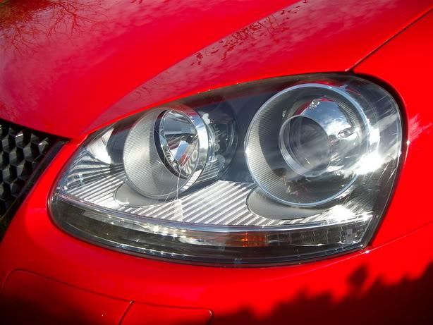

We're here to help answer dumb questions and this dumber here doesn't know the answer other than to show you that Xenons on my 06-build 05-plate GTI look like this:

Standard Halogen headlights  :pomppomp:

They should be a nice crisp bluey White colour if you have xenons. When you turn them on do you see the light it produces move up and down to check the levelling? You should be able to tell from the pics of the actual headlights posted above. I seem to remember xenon bulbs costing a lot more to replace than halogens! Good luck.
