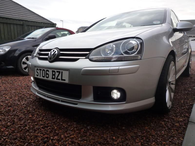

Update time again!!!
Votex front splitter
scott :happy2:

« Reply #151 on: March 06, 2011, 05:11:23 pm »
Looks very different fitted to the normal bumper, but in a good way  :wink:

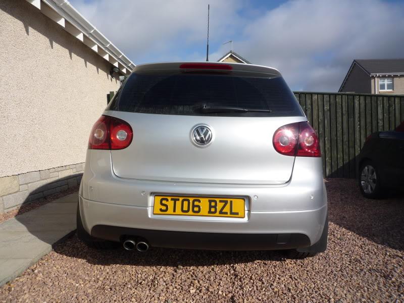

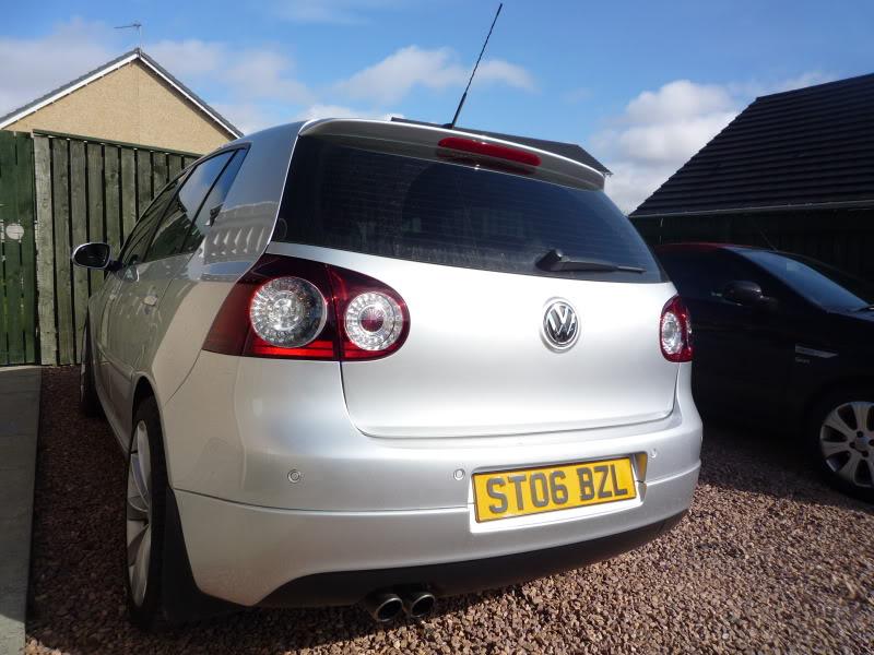

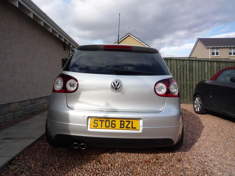

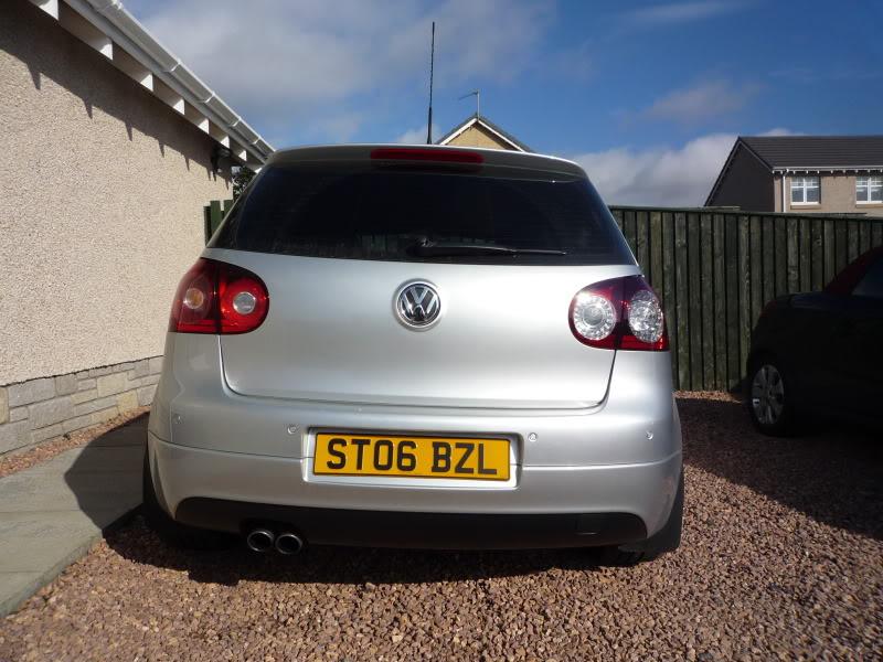

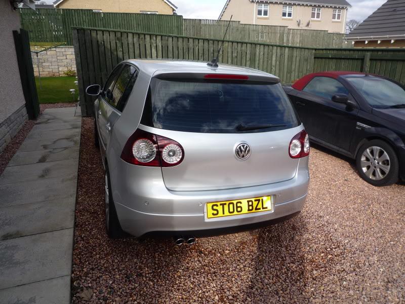

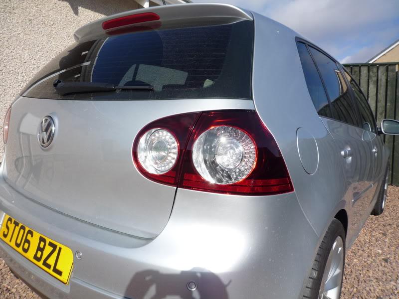

« Reply #156 on: March 19, 2011, 03:17:56 pm »
Time for a new mod!!!
Valeo LED rear lights and factory fitted parking sensors :wink:
Before...
Half & half...
Rear fog modified...
Night pictures too come :signLOL:
scott :happy2:
« Last Edit: April 24, 2011, 09:35:32 am by golfman »
Vag-com Hex+Can in scotland
I Hate Timewasters...
Re: My Modded mk5 golf gt tdi(188bhp)
« Reply #157 on: March 19, 2011, 05:02:54 pm »
Great, you got some!  :happy2: They suit your silver car very well.

« Reply #159 on: March 19, 2011, 06:37:18 pm »
Very nice Scott  :happy2:
You went for the clear fog with red bulb then? Looks better IMO.
Did you copy and paste the long coding in? Also did you do it before or after fitting the LED's?
Offline golfman
  • -Given: 17
  • Posts: 1088
« Reply #160 on: March 19, 2011, 06:52:58 pm »
Cheers Lee
yes i went for the red bulb a much better and easier solution(thanks for that)
yes i copied and paste the long coding in after i fitted the LED's
scott

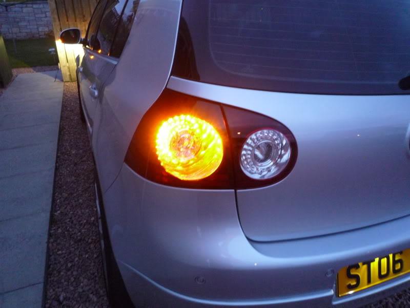

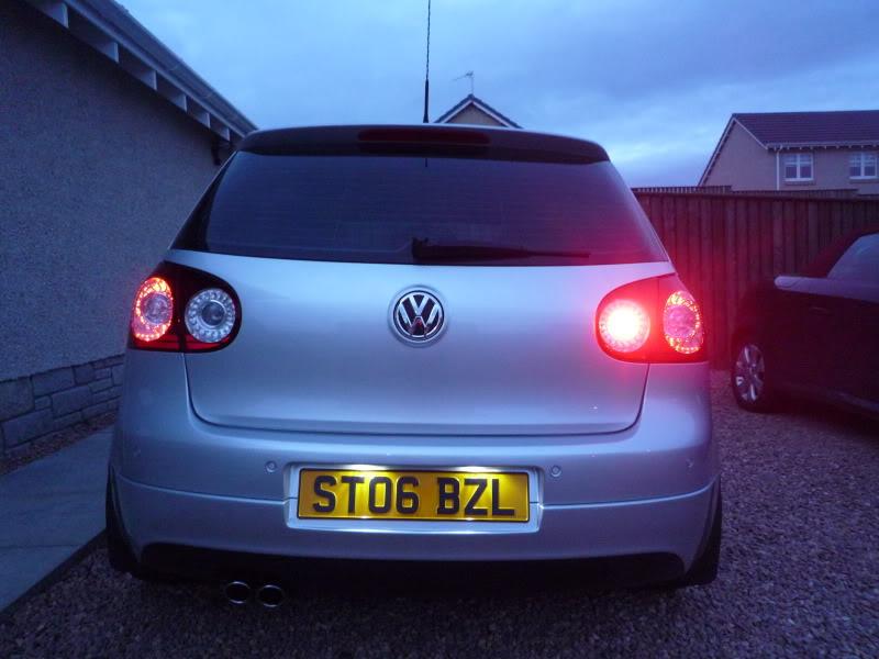

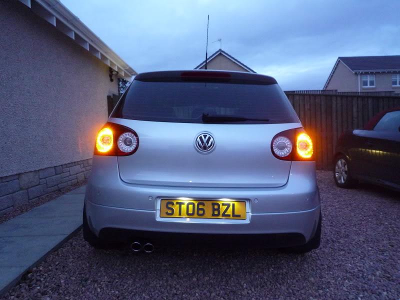

Offline golfman
  • -Given: 17
  • Posts: 1088

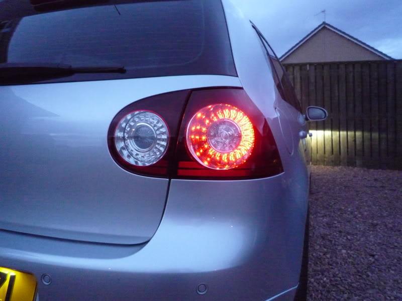

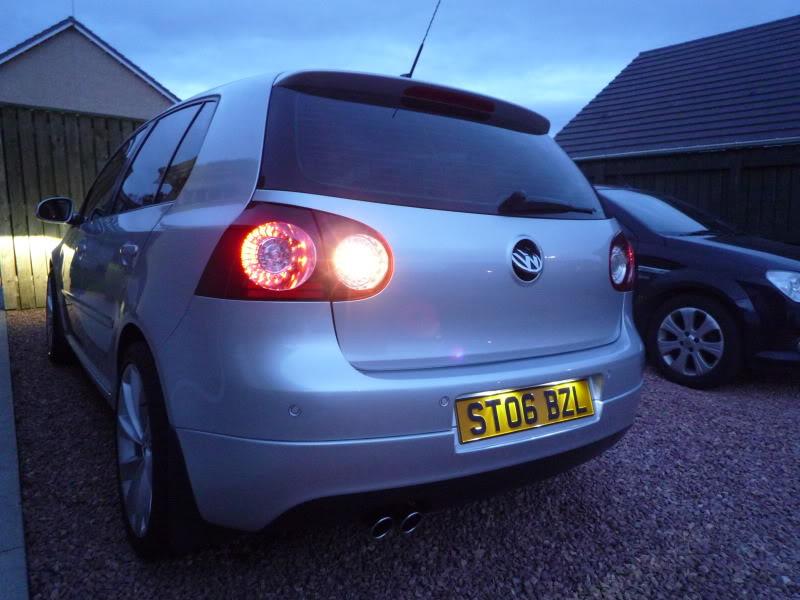

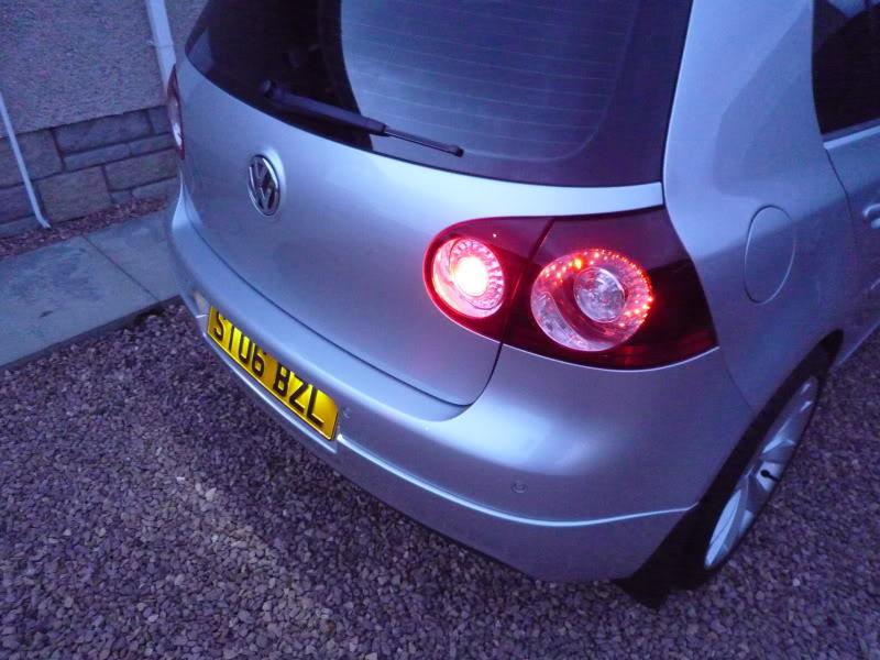

« Reply #161 on: March 19, 2011, 06:57:41 pm »
Night pics!!!
scott :happy2:
Offline apollo13
  • -Receive: 47
  • Posts: 1017
« Reply #162 on: March 19, 2011, 06:59:28 pm »
No problem mate  :happy2:
Try altering it in the long coding. Its 09 Cent Electronics, BYTE 9, Modify the value to 0
Also you want to turn off cold diagnostics to all the rear lights now as I've been told the pulses kill the LED's.
Not sure if its true but I didn't want to risk it  :rolleye:
EDIT- Looks to me in those pics that the coding has worked fine??
