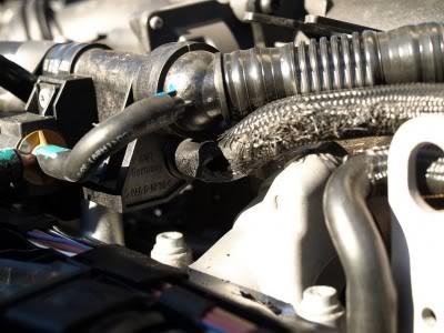

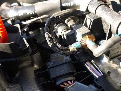

Try this - owner complained of power loss.............. copied from the rocco forum
Quote from: Gary_Monkey
LATEST UPDATE
Hi All,
Got the car back from the dealers yesterday and guess what - the power loss in the engine was due to mice gnawing through pipes which feed the turbo!!!
See pics below:
 [ You are not allowed to view attachments ]
The little buggers had crawled into the engine bay and had a feast on my turbo pipes. The chief technician, at the dealer, said it was the worst case he'd ever seen.
Anyhow on the plus side - at least it isn't a goosed turbo which was my worst fear. The parts have been ordered, 3 different bits of hose into total, 10 working days on back order.
See parts list below:
Part no. 03C133518AS ----- £11.55
Part no. 03C145718Q ----- £6.11
Part no. 03C145718R ----- £6.11
On the downside it's going to cost me nearly £200  :eyepop: to put right (mostly in labour). Wish I could do the job myself but the head mechanic said they need to reset the engine management as it's thrown a wobbler due to pressure loss etc, etc, and there are some special jubilee clips etc, etc.
So all-in-all it would be cheaper to buy a cat and make it live in my garage than pay the dealer to fix the problem  :grumpy:
