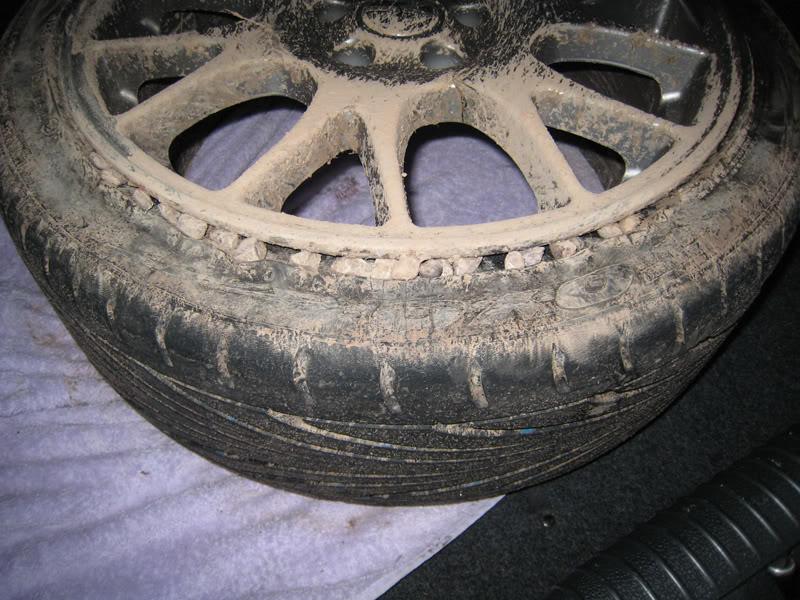

Trip into the gravel at The Old Hair Pin (Donnington) was a good excuse to get some 18” BBS CH black edition wheels  :ashamed:

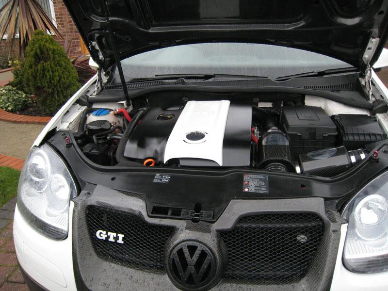

Another trip to The TT Shop and Revo Stage 2+, Autotech pump, Forge Intake & Catch tank
I modified an engine cover to fit with the Intake

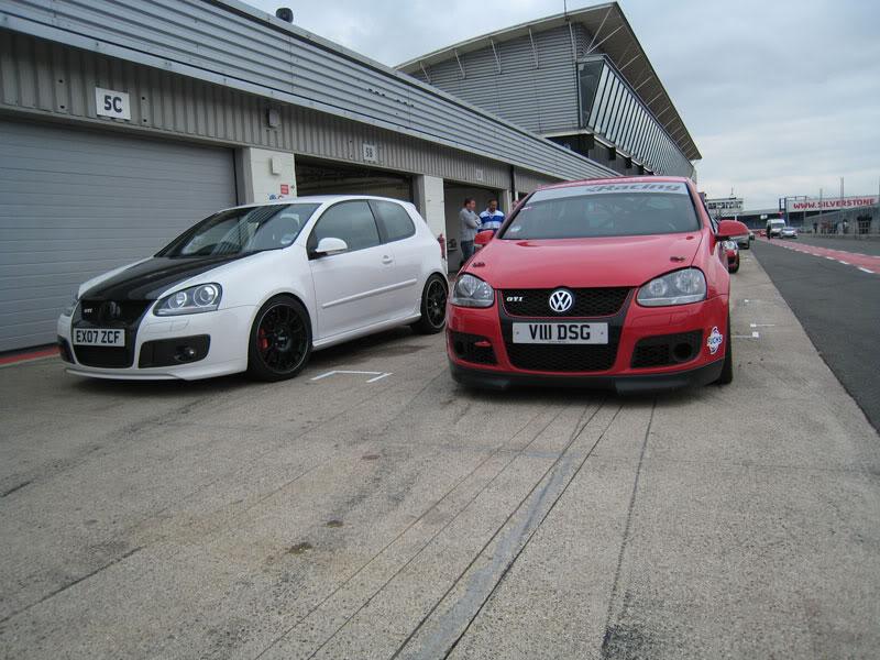

Track day at Silverstone with Phil and Simon and their VW Cup cars, just before their first season.

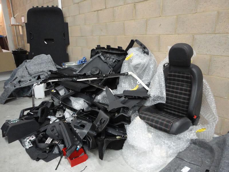

Complete A/C about 10kgs

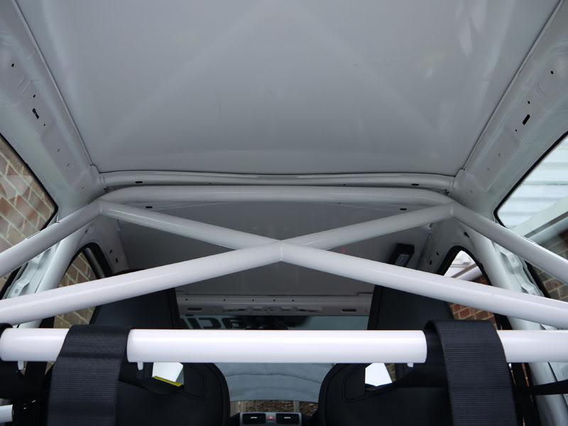

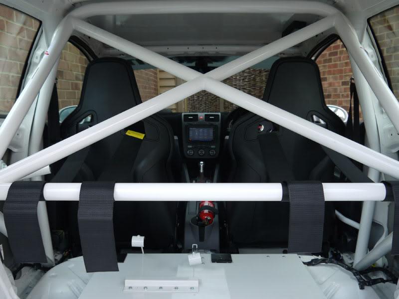

4130 Chromoly Steel (CRMO) Rear roll cage
Remove spare wheel well and finish level
Mmmm Furry
Finished
Recaro Sportster CS Seats & 4 Point SCHROTH Harness

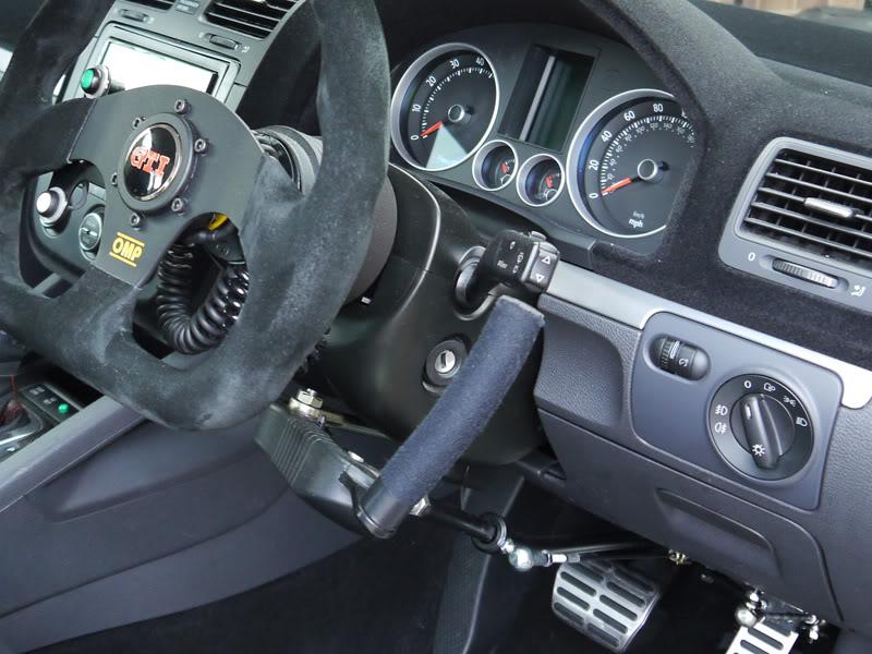

OMP Superquadro Steering wheel with quick release & horn,
Lost the MFSW buttons & Carbon Paddles so Simon @ VWR fitted UP/Down shift buttons & a Stalk thats gets some functions on the screen

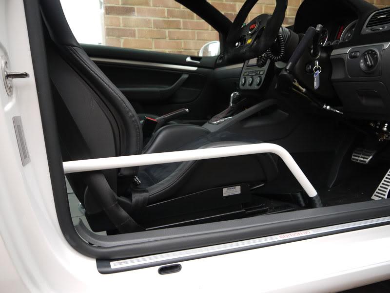

For those that may not know me, some years ago I had a motor bike accident that left me in a wheelchair (paralysed from the chest down) and I drive with hand controls, on the right hand side, Push for Brake – Pull for throttle, obviously has to be DSG.
The lads at VWR have done a great job  :congrats: and we have designed some things specific to my needs:
Extended roll bar to help me transfer from Recaro to wheelchair as the side wings make it quite difficult.
Fixings for wheelchair wheels and lock down points for frame.

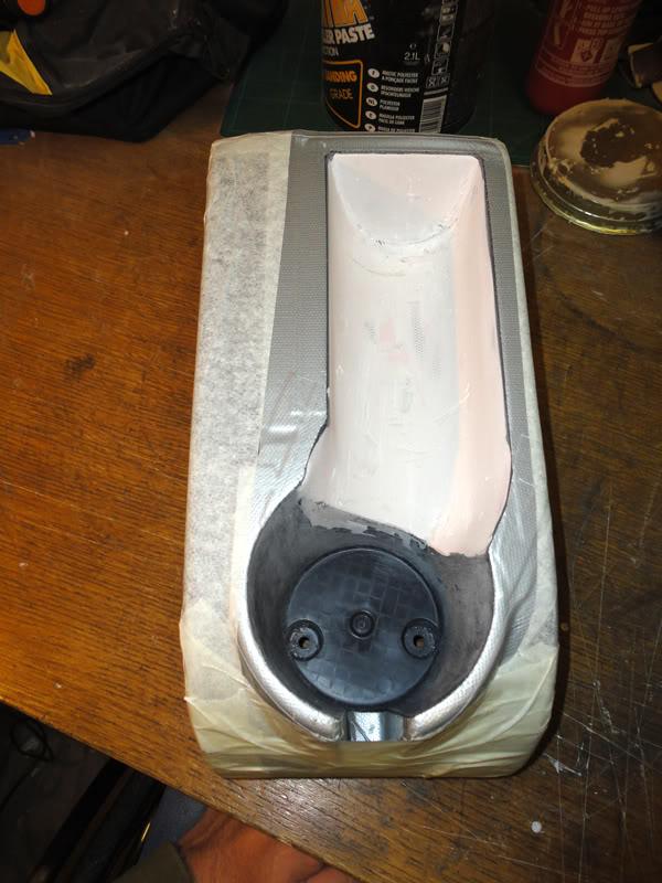

Dug out the old Dremel and adapted the centre console to take a small fire extinguisher.
