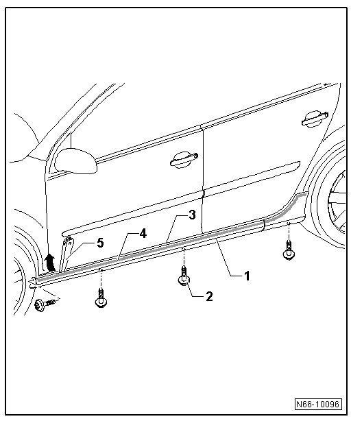

I have this guide:
–   Remove bolts -2-.
–   Before removing, heat sill extension -1- in bonding surface area -4- with hot air blower -V.A.G 1416-.
–   Loosen adhesive tape -4-, by carefully inserting a plastic wedge -5- between sill -3- and sill extension -1-.
–   As soon as adhesive tape comes loose, lift sill extension -1- up -arrow- out of retaining strip.
Has anyone actually done it though? did you manage to get the skirts off intact and in one piece?

JoesGTI managed 1 the other was a gonna  :wink:

A hair dryer and patients my boy. You would really have to yank at them to split the plastic.  :innocent:

reckon if you put the car in a warm garage thatll make a big difference  :happy2:
You could in theory use some alcohol (non paint effecting) and use a dropper into the join to soften it before attempting the job?

I did it on my GTI, they are a piece of cake, apart from if when they were installed they used a big blob of contact adhesive on the rear part of the skirt, you may be lucky but possibly not..

« Reply #13 on: June 15, 2009, 01:33:15 pm »
Thanks for this guide mate, just did mine in under half an hour.  That including a 10 minute conversation with a lad that has a MK4 and offered to buy mine, and an argument with one of the neighbours because we were talking outside his house!
I didn't apply any heat though, what I did was start from the back, then used a CD wrapped in stockinette to break the seal.  No marks on skirts or car, and both skirts are in one piece.   That said, I was one of the lucky ones, there was no contact adhesive in sight.
