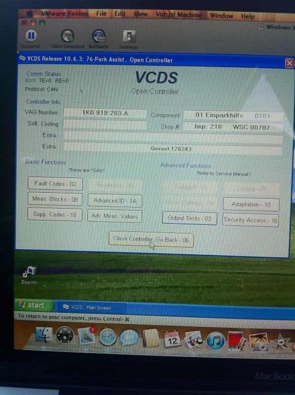

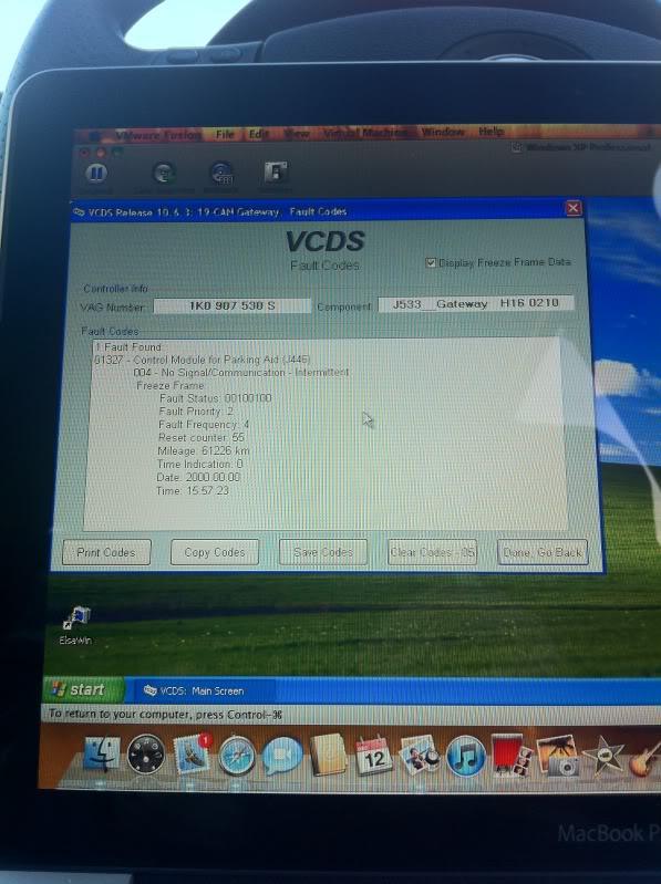

« Reply #23 on: December 12, 2010, 09:57:32 am »
These are the screens on vagcom im getting if anyone can help!!!
cheers
scott
Vag-com Hex+Can in scotland
I Hate Timewasters...

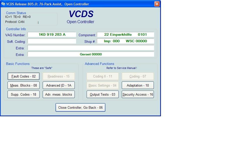

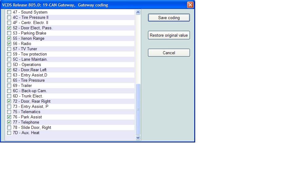

Of course you have activated in in your can gateway right? (didn't bother to read the whole tread through, sorry)
and this is mine
Hope this might help you out Scott  :drinking:
and this is mine
Jake thanks for that  :happy2:
i have activated it in the can gateway but darren thinks that its because it doesn't have enough power as i only have it on a 5 amp fuse in location 12,so he thinks it should go to location 14 with a ten amp fuse which is a permanent live!!!
can i also ask do you have the passenger mirror dip?if so can you help me with the coding from your car mate :happy2:
cheers
scott
and this is mine
cheers
scott
You had to rub my nose in it, no i don't have the passenger mirror dip, puddle lights and folding mirrors, but i want it soooo bad  :xmaspresent:  :grin:   :drinking:
Sorry can't help you with that one   :sad1:
