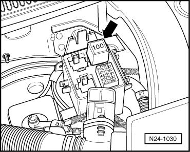

Could be the secondary air pump relay...this is what make the high idle on start up so if its not doing what it should then I would get this taken off and looked at or replaced.
Function of Secondary Air Pump
The secondary air system blows air in behind the exhaust valve for max. 65 seconds after a cold start (+15 °C ... +35 °C coolant temperature). This produces an oxygen-rich exhaust gas, causing after-burning and reducing the heat-up phase of the catalytic converter. The Motronic control unit -J220- activates the secondary air inlet valve -N112- and combination valve via the secondary air pump relay -J299-. Additionally, after each subsequent engine start (up to max. 85 °C engine temperature), the secondary air system will, after a 20-second delay, switch in for 5 seconds during idling and will be checked by the self-diagnosis.
This is where the relay is

cheers for that darren  :happy2: il check that now aswell, are there any signs of failure? is it the bit in the pic with 100 writen on it?

« Reply #11 on: December 02, 2010, 01:07:12 pm »
Yes Joe thats the relay if you take it out and it doesn't make a difference I would say its that? I cannot see any fault finding pages on Elsawin but I would also check the fuel injection relay aswell has that could be on its way out and would cause bad starting problems, once started it shouldn't make a difference with performance so check that then it will be down to any blown fuses.

« Reply #12 on: December 02, 2010, 01:33:30 pm »
ive found it but the one with 100 writen on it is in the one next to it??
Been put back in the wrong slot by previous owner? please dont move it over because ive said that I dont want responsibility for blowing your car up!  :scared:

Has Rich said it could have been put in the wrong place but if there is any other relays round it it could be that there is other options on the car that place the 100 relay in the place it is.
While we have this cold weather put your hand on top of the relay and get some one to turn the golf over,  once its started keep your hand on it and you should feel it click.
