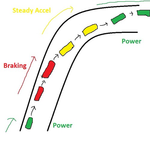

Hi guys,
I was having a think ealier about how compitant i'd be on a track, come a track day etc...
How would you guys approach a hard right corner for example? With regards to braking and acceleration at what points etc.?
I've drawn a ridiculous picture in paint, as how i'd drive a rear wheel drive car ( I've done a few charity ferrari track day rubbish things under tuition)  - but does the same still apply to a fwd golf? And am i totally wrong?  :grin:
Any advice or pictures would be fun  :happy2:

haha brilliant effort on the pic i rekon that will take some beating  :happy2: but i rekon thats pretty much spot on obv depending on the corner depends on how much throttle half way round....

haha! took me a good 3 minutes  :grin:

I'm not an expert but I would advise:
- Start slow and well within your comfort zone and gradually build your confidence and knowledge of the track.
- Always do your hard braking while the car is in a straight line and consequently more stable. Identify your braking point markers as you become more familiar with the circuit.
- Turn in towards the apex and start progressively applying power as soon as you can see the bend opening up.
- Basically 'slow in and fast out' is smoother and more stable.
- Do a cool down lap and never put your handbrake on when you park!
Be aware that many tracks may have a sequence of corners where you would be faster if you sacrifice the racing line on one corner to better get round the corner which immediately follows.
Never do another lap when you're thinking: "I'll just do one more lap" and always take a short break between sessions to keep yourself fresh.
Smoooothness is the key imo.

if in doubt flat out. :wink:
not to sure on the kink as you exit the corner in your pic though :laugh:

Tuition, tuition, tuition.. until then - slow in, fast out.
Depends on your style and car set up too, I use oversteer and trail braking, this comes with time and confidence, so my picture would look very different to yours. Some people never feel comfortable with this and prefer to have a 'planted' back end. In this instance stick to SI/FO otherwise you'll just overcook it and understeer.
Oh, you missed the apex too  :signLOL:

As danza said really,
it completely depends on how the car is set up, if its relatively standard the car wont allow you to drive it how a properly sorted fwd car should be driven in the track, but then saying that if its set up properly it would be really nervous to drive fast on a back road blast due to it relying on having temprature in the rear tyres...
I would start off with how you have drawn it in your pic, folowing the basic rule of thumb of brake in a straight line, then build the speed through the corner.
if you want to go past this stage you will need to throw that rule of thumb out the window, then it becomes a case of how much confidence you have to be able to slide the car! As tony said, You then start braking deeper into the corners and using the power to control the degree of slide you have going through the corner, if its done right you should have very little slide but enough to be able to keep the throttle on without worrying about any sort of understeer... so its more of a fast in fast out technique! you have to be very smooth with this tho not using much steering input at all!
The beauty of fwd is that you can have a massive moment and still get away with it, but just remember to take the opposite lock off just as quick as you put it on... otherwise you will be going back the opposite way haha
