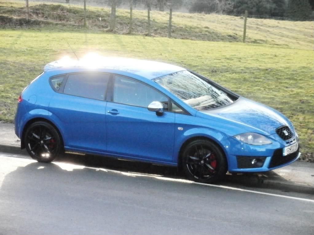

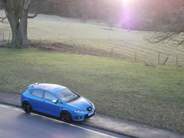

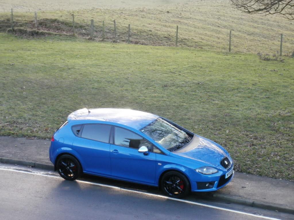

Put some elbow grease onto the car today  :smiley:

Looking nice and mint mate.. Fingers crossed the roads won't be to bad tomorrow either..  :party: Look forward to meeting you anyway mate and will be good to see how ours compare, especially considering they were identical on PDT's rollers..  :laugh:

very nice car mate !! and i might have to steal the idea about using the standard downpipe !! :D
quick question, where did you get the gauge rings from ?? ive been looking for a while but havent found anything !!  :D

Cheers, was yours the healthy Stage 1 at Motoscope last week? The exhaust seems to work just fine  :wink: The gauge rings were from ebay and about £45 delivered. Very difficult to fit though !! A very tight fit ! I think SEAT used to do their own for approx £75 but they didnt include the vent rings. They should still be available and Im pretty sure the ebay ones are still available too. They brighten up the instrument cluster no end  :smiley:
