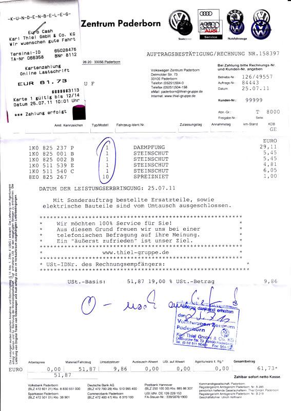

Re: improving aerodynamics with OEM parts
« Reply #147 on: July 25, 2011, 09:54:35 am »
Right so Ive come away from the dealer with no parts (collect tommorow) and 61euros poorer.  Part numbers to follow.
Point to note is the Audi part numbers were available to order.
Got a feeling from your post above Im going to be short of a few clips and screws :(
« Reply #148 on: July 25, 2011, 10:06:53 am »
Ordered these;
« Reply #149 on: July 25, 2011, 10:38:34 am »
When you go back tomorrow you will need these to fit them all:
N 909 591 01 fixing kit   x4
N 103 546 02 fixing kit   x10
(x3) 1K0 825 951 Hex headed bolt (Combi) 80p each M6X20 hex socket head bolt
(x4) 8E0 825 267 A spreader rivet 10p each
you might also need these depending if your rear brake cables are on the top of the rear arms or in the middle like snoopys were.
(x2) 1K0 609 734 C brake cable clamp 76p each
(x2) N 102 854 02 Bolt 18p each
you will only need 4 of the 8E0 spreader rivets not 10 unless thats a random number of fixers.
The 3 bolts are for the main engine tray and hold the rear on the subframe (that holds the bottom engine mount.) the rest of the screws will be holding the existing engine cover in place.  did you see the comparison picture of the new and old engine cover did it answer your question above?
With your car being lowered you might see a better improvement as well than mine as you allow less air under the car and having a smaller gap between the car and the ground helps you achieve a better clean flow of air.
