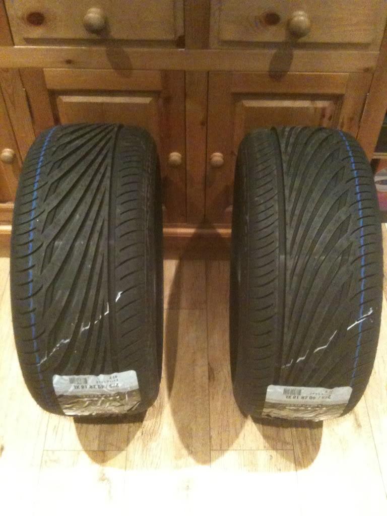

I know they are labelled inside but this is a picture of how they will be on the front of the car looking from the front,
does that look right to you guys, funny tread pattern

the one on the left is the wrong way around

Quote from: Aaron_RJ on January 05, 2011, 08:12:48 pm
It's not mate
They are Asymmetric so it doesn't matter how they go

Quick answer
the tyres have directional arrows on them chap.

thats how they are on my gti :) i thought it was wierd but they work fine :)

cheers guys had me stumped for a bit, so as long as the side marked inside is on the inside they're ok

I had a garage try and tell me they were wrong so it's not just us "non-expert" types that get stumped

If you look on
www.vredestein.co.uk
you will see they are correct
,& this is how mine are fitted.

same as fitted to mine, they do have a arrow on the sides to show direction

I had this confusion when I had these fitted too, took some time to figure out.
