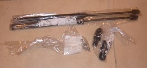

The boot pop is a mod i quite fancy......can you advise how and what bits are required...i have seen it somewhere else but cant find it now

I found all the boot pop information on here !
This is what you need
And here are the list of parts.
2 x 6Y0 827 550 C (Skoda Fabia gas springs)
2 x 1K8 827 761 C (Scirocco bumpers)
2 x 1J6 827 439 A (Seat Leon ball pins)
I got all my parts from TPS, and coding done at the Phirm in Hook where they also turned on one touch unlocking for all the doors and boot.
Postman came today  :wink:
