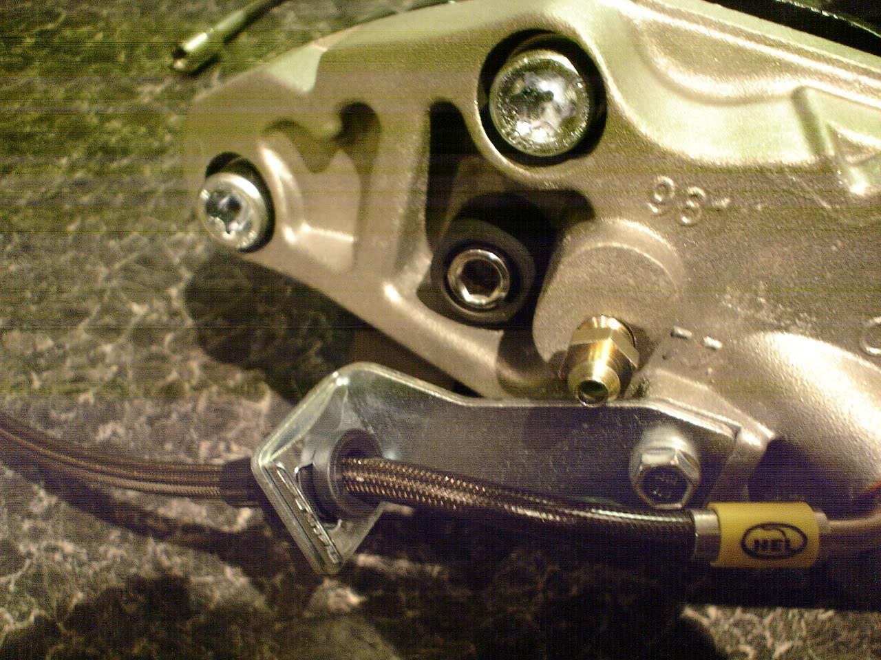

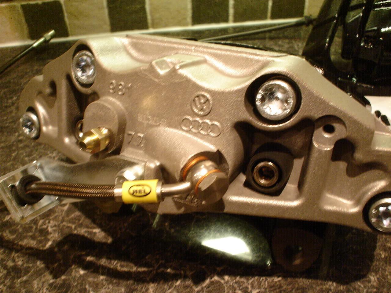

Quick Pic of how the VAG10 hoses supplied by me attach to the caliper, the HEL official R32 hoses are shorter with only one mid line fitting, the VAG10's also have a 150 degree bend to the fitting that enters on the caliper, they're very custom. They also come (normally) with the clips and stainless banjo bolts and copper washers!
They're very secure and dont "flap about" as somebody suggested, these also attach to the strut and share the same path as the OEM hoses

The fabled kitchen work surface   :notworthy: :notworthy: :notworthy: :notworthy: :notworthy:

Scratched really badly!! Even when the brakes have gone - Im still getting it in the neck every time she makes tea!
