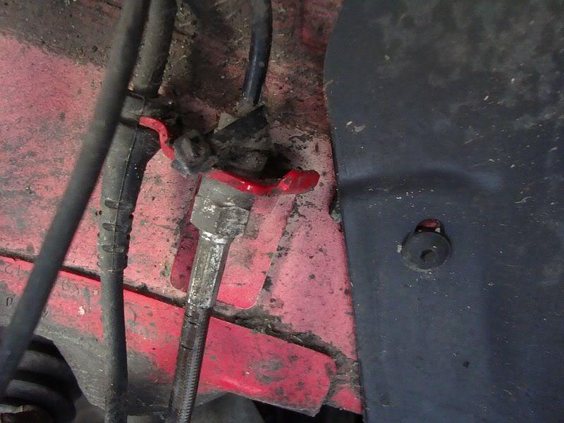

Had the first MOT done at my local dealer today and gutted to find out it failed!  :sad1:
Reason for the failure was listed as the 'front brake hoses insecurely mounted', turns out that the HEL hoses i had fitted as part of my front S3 brake kit dont appear to have the correct clips or fittings to locate securely on the body mounted clip at the end of the hose?
The area thats the problem is the connection from the rigid hose coming out of the inner arch to the flexi hose, seems the oem hose has a clip or shaped hose fitting to allow it to be firmly held in place at this connection whereas the HEL ones dont?
Disappointingly my usually trusted installer failed to mention that there was a problem with the hoses when fitting them and secured it with cable ties! This has brought about the MOT failure due to the lines being able to move around to some degree and also raises the issue of flexing on the rigid pipe which is potentially a concern regarding fatigue on this part too...
So my question is what has everyone else done to overcome this problem when fitting braided hoses? My options are limited to trying some different hoses or buying some oem lines to get through the MOT but want to try and avoid having to mess about with a system that is working great apart from this issue...
Dealer has mentioned buying and fitting some oem hoses and will do me a reduced price on the swap over and bleeding etc to get within the 10 day retest timeframe but even that will cost £60 plus the parts  :sad1:
Help would be greatly appreciated!

2 Cable ties.
It really is as simple as that, I have seen this problem time and time again with modded cars and our MOT tester always fails them, as long as the cable tie holds the metal part of the union of the 2 sections of pipe securely in the bracket they cant fail it.
Wrap a cable tie from either side through the bracket in a figure of 8 pattern.

Cable ties as PDT says, or if its the problem Im thinking ok, then there are OEM clips that will work to secure the line.  If you look at the rear lines there is a black spring clip.  Just buy a pair of them.

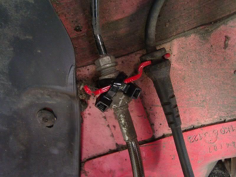

« Reply #8 on: January 09, 2011, 12:03:28 pm »
Thanks for the replies and the ideas fellas!  :happy2:
Had the car up and had a good look at the lines and even though they were only on with 1 cable tie they were pretty secure imo, but to be sure i've gone for 2 ties in a figure of 8 style and they are rock solid now!

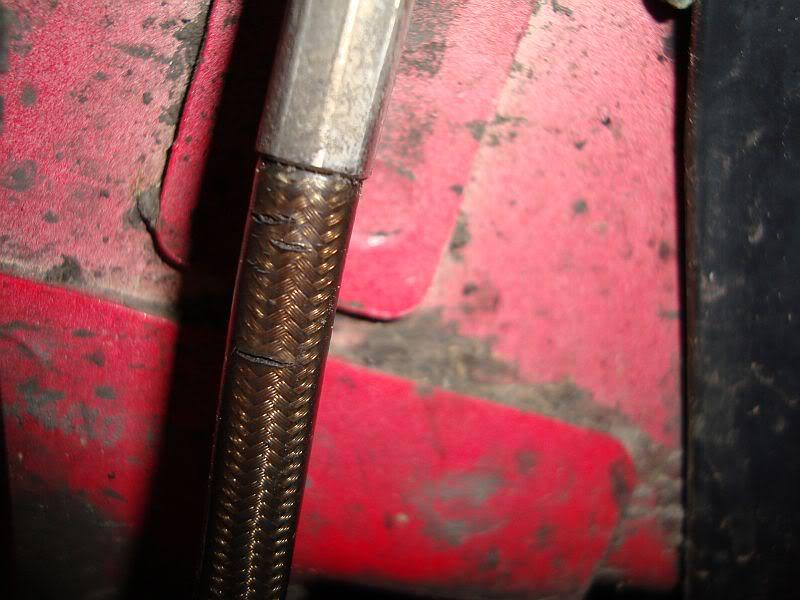

Did notice something whilst doing it though which has me a little worried, 1 of the lines has started to crack on the outer sheath, should i be worried? lol  :scared:

Thats exactly how I have done it in the past, never failed.
Those cracks are cosmetic.

Mine failed on the porsche kit on my mk4 off DaveB for the same reason. The MOT tester just cable tied them and passed them :happy2:

Beddie... To secure the hose to that mount you should have a brass clip/spring. That goes onto the HEL hose first before you screw it up to that bracket! Kind of acts like a spring to pull the cable down into the mount!
