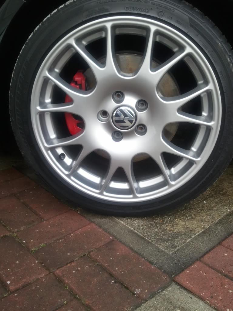

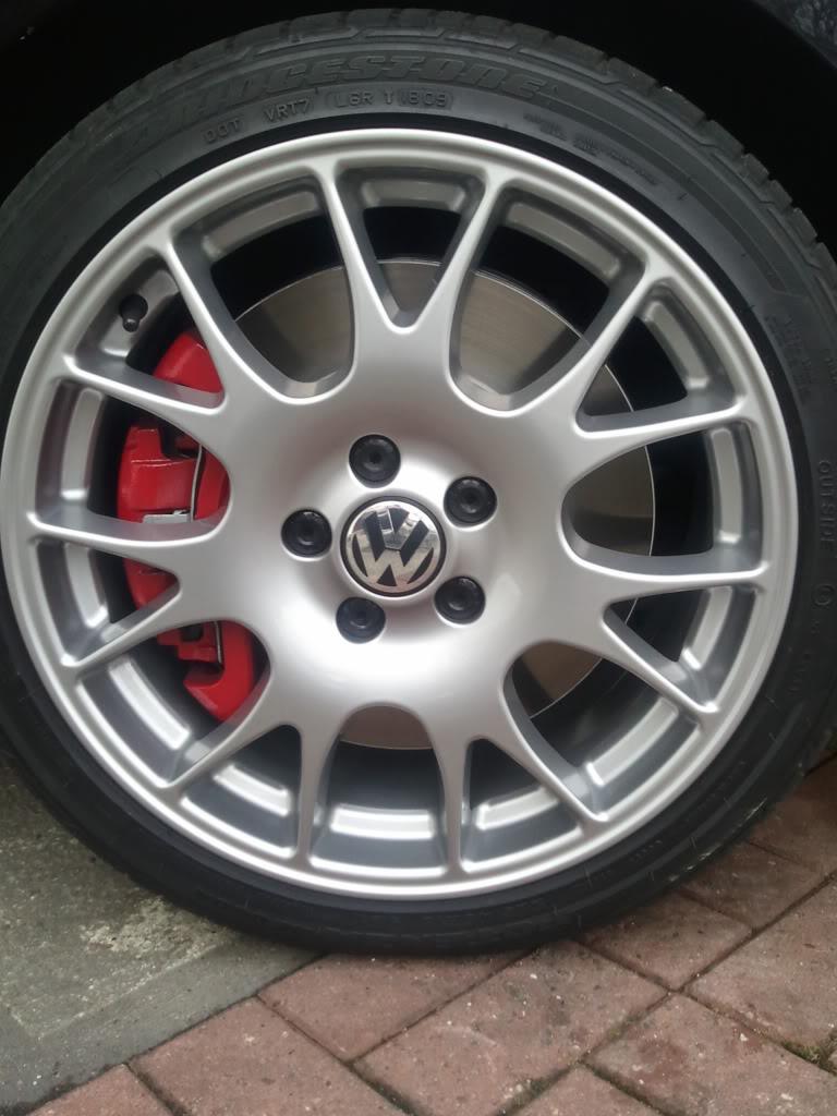

no worries dude! ive just done my fronts, did you get the full S3 set off ebay and pay £453.00 for them? if so you were bidding against me, ask stokeballoon about the rears as he has done the conversion so did stevie P iirc. see pics of before and after (fronts)
Standard Gti/Edition 30 Fronts 312mm
R32/S3/Cupra R Fronts 345mm
« Last Edit: March 28, 2011, 08:15:22 pm by flyboy1976 »
NICE !
