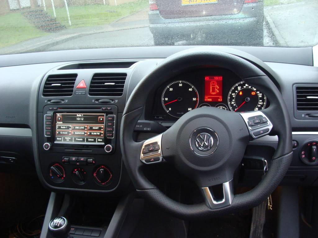

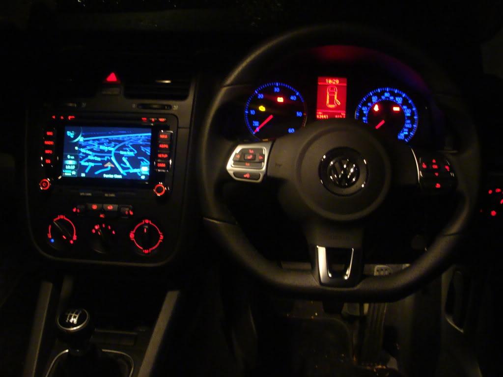

How about a mk6/Rocco MFSW like mine, IMO just gives the interior a lift  :happy2: (and the buttons work)

That is nice. Prob cheaper than an r8 wheel too! Is that the wheel that goes in the golf r aswell?

Same wheel just the R wheel has piano black (gloss) inserts instead of the silver/ali look  :happy2:
I paid about £200 with the airbag, was a while ago now though.
