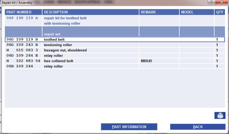

The kit doesn't include new bolts -
The information is contained within the factory repair manual, the dealers will have it.  It seems quite simple to me, either way they are responsible.  No bolts is a fcuk up and replaced bolts carry a warranty as does their workmanship.

Thanks for the info. I don't suppose you have an extract from said manual that quotes the replacement of the engine mounting bolts near the cam belt?

« Reply #17 on: January 24, 2011, 09:57:38 pm »
That diagram is the engine mount next to the Cam Belt.
Sorry, wasn't being very clear. Dowloaded the diagram but was wondering if there is any text to go with it that says these bolts should be renewed when the cam belt is done.

« Reply #19 on: January 24, 2011, 10:16:00 pm »
No there isn't any text mate.
Like I said it's open and shut, if they replaced the bolts and they failed the bolts would warranted.  If they didn't replace the bolts then they fcuked up.
