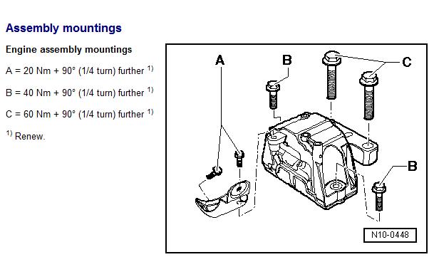

Gutted if it was their fault, the tech did mention the cam belt but said the bolt was secure to the block. Maybe I should pay a trip back to the dealer?
MK5 (06) GTI; Previous: (57) Audi A3 TDI & (05) Seat Leon Cupra R 225 & (51) Seat Ibiza Cupra 1.8 20VT

I've said this a few times before that the bolts should be replaced following a cambelt change.  I know there was some debate with T_T and he insisted it's not the case but the manual does advise them to be changed.
If you weren't invoiced for new bolts and they weren't fitted then actually they've fcuked up.  If they were new bolts then they have failed  they will carry a 12 month warranty as does all work carried out by your VW dealer.
You've been had mate  :fighting: :fighting:
There were no bolts specified on the cambelt invoice but there is the below. Are the bolts included in the kit? If not do you have a copy of the manual you mention?
W06F 198 119 A- REPAIR KIT
The only other thing is the Water pump.
