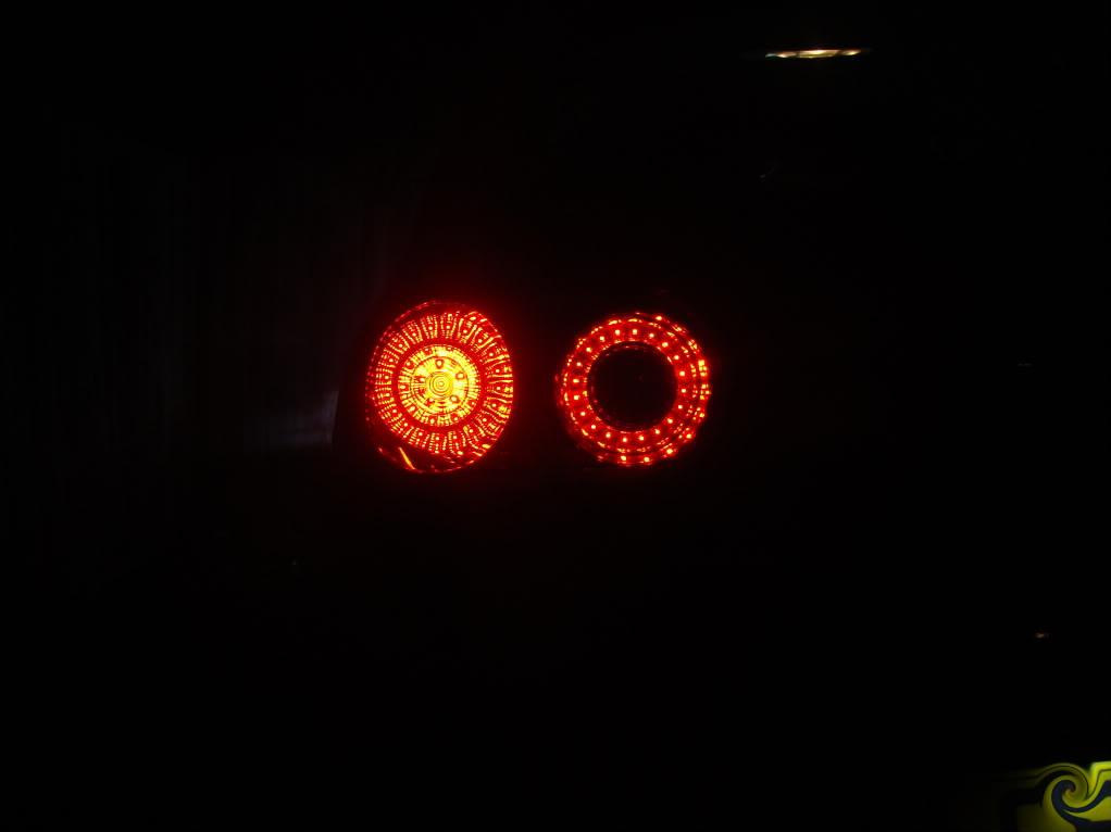

As said in my PM unless/until they are modded you can only really turn off the tailight function of the centre part of the main tailight giving you a 'ring'.
Before coding
After coding
Obviously those pictures are with the inners modded but you get the idea.
