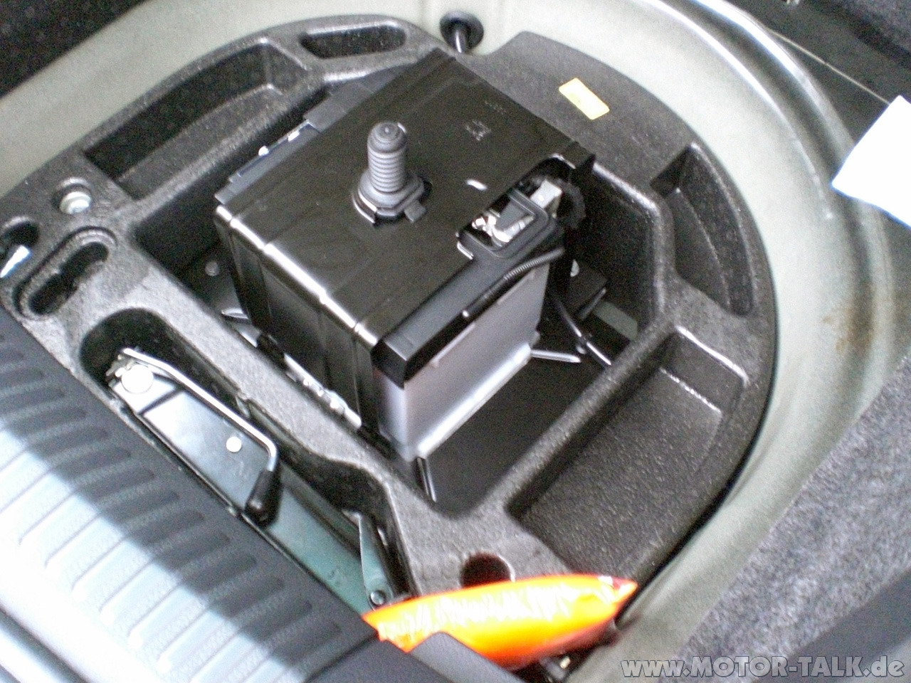

So, a Polo GTI for your next car then? :wink:
with the battery in the rear (from factory)  :happy2: :happy2:
Is that even possible?

the bruce: nice! That battery in the back might be more efficient than the 25kg of dead weight added to the rear bumper  :grin:.
