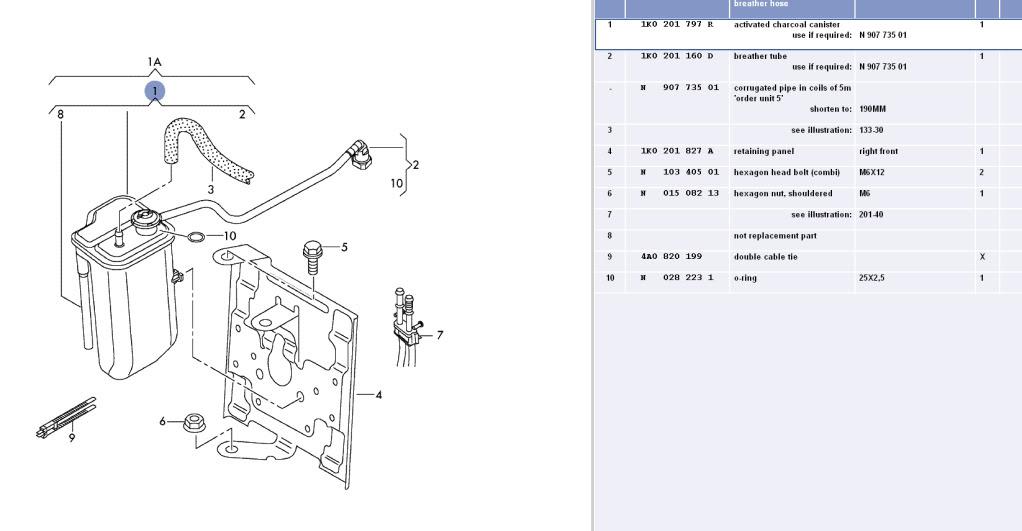

Broke the hose off my charcoal canister can anybody give me part numbers for parts i need   Thanks
or even just a ETKA screen shot
Offline Maximum Suction
  • Posts: 21
Re: Part number help needed
« Reply #1 on: February 05, 2011, 02:09:56 pm »
Think this is what your after....
 :smiley:
Offline vRS Carl
  • -Given: 282
  • -Receive: 241
  • Posts: 3088
« Reply #2 on: February 05, 2011, 02:26:55 pm »
Part no. you need is 1K0 201 160 BG - Breather Pipe. Costs about £9 Inc Vat ( i replaced mine about 3 weeks ago)  :happy2:
That ETKA is a bit out of date and if you use the Part no. that has been highlighted you will get the full Cannister which is about £95 inc VAT

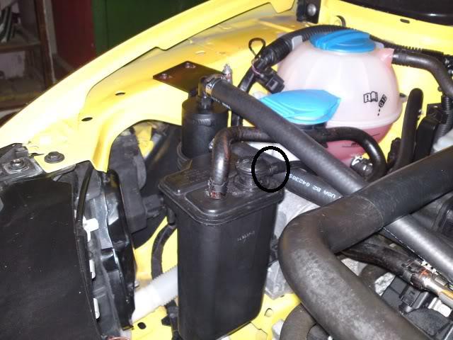

Does 1K0 201 160 BG - Breather Pipe come with the plastic cap/plug in the top of the Canister if it does how do you get the old one out. :happy2:
Offline vRS Carl
  • -Given: 282
  • -Receive: 241
  • Posts: 3088
« Reply #4 on: February 05, 2011, 02:41:29 pm »
Yes it does it's all attached.
It comes out by twisting anti clockwise about a 1/8 of a turn and then it pulls out. They are quite stiff and they are even stiffer to get in due to the O-Ring.
When you get the new one put a fine layer of oil on the O-Ring to get it to go in easier :happy2:

Cheers Carl got the cannister end off but how does the other end com off  sorry for all the questions
Offline vRS Carl
  • -Given: 282
  • -Receive: 241
  • Posts: 3088
« Reply #6 on: February 05, 2011, 02:50:05 pm »
If you follow the pipe along with your hand to where it connects near the coolant bottle you will feel a little button on it at the end. Just press that in and it lifts straight off :happy2:
Offline yin
  • -Given: 77
  • Posts: 420
« Reply #7 on: February 05, 2011, 02:53:41 pm »
Thanks Carl got it all off   :drinking:

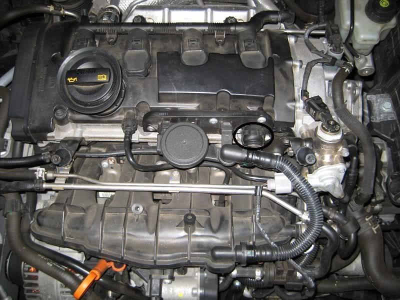

Carl have you got the part number for the oring as circled here  :happy2:
Offline vRS Carl
  • -Given: 282
  • -Receive: 241
  • Posts: 3088
« Reply #10 on: February 06, 2011, 09:51:31 pm »

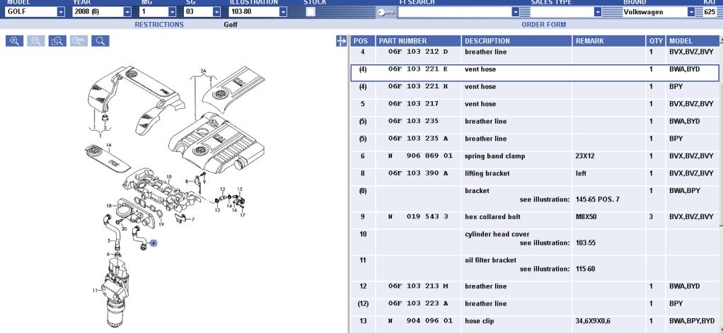

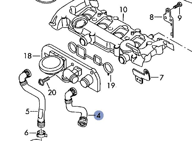

Yin,
The O-Ring doesn't come on it's own. Its all part of the PCV as per the pics.
Depending on which bit you need the breather line (plastic hose) part no. is - 06F 103 212 D
The PCV is - 06F 129 101 L
The Gasket is - 06F 103 483 E
Some pics
HTH
Carl

Having just looked on mine it's the Plastic hose (06F 103 212 D) that you need as the O-Ring is held within the end of the pipe :happy2:
Offline yin
  • -Given: 77
  • Posts: 420
« Reply #12 on: February 06, 2011, 09:59:07 pm »
yes just after the o ring as mine is split :happy2:
