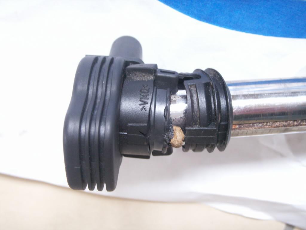

Do you mean coil packs like this:
and a close up
When mine failed a few years ago it gave no warning and I was stationary by the side of the road within 30 seconds.
