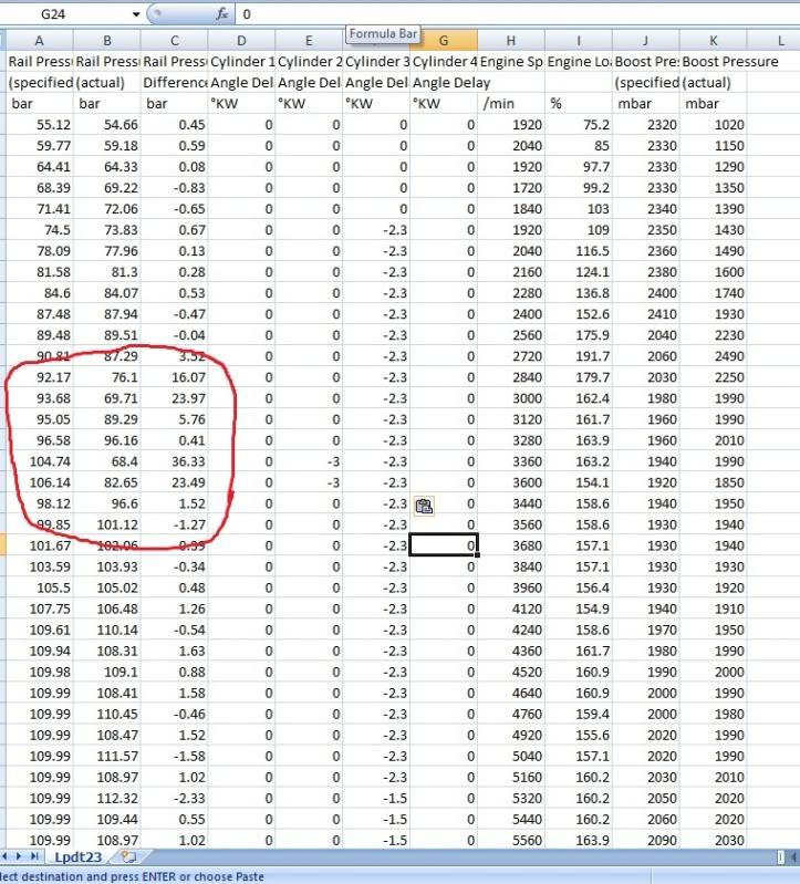

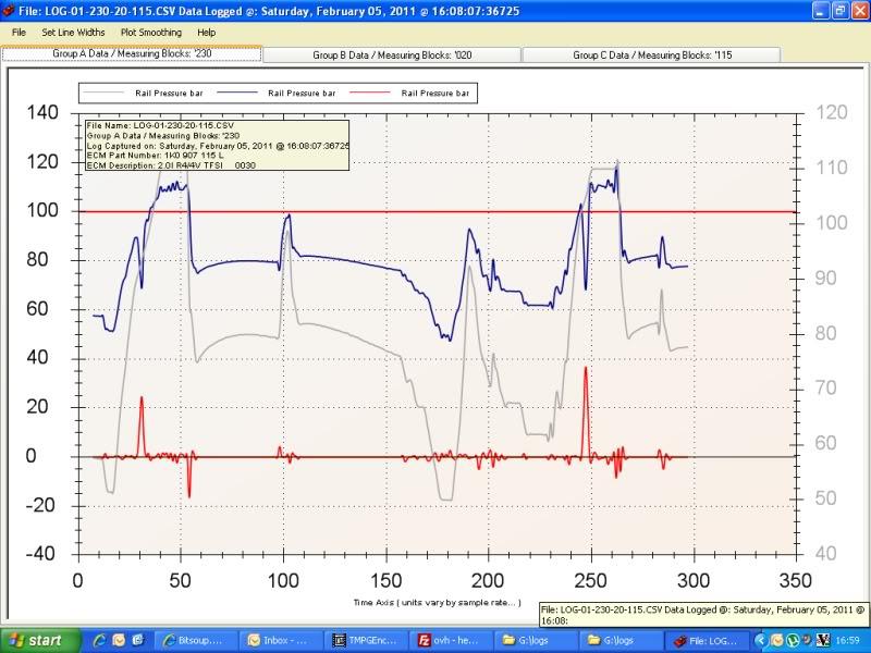

Only problem is that I seem to have a big fuel cut at around 3000rpm, so this must be causing my lower torque figures than the other companies produce. Looks like I might have to get a new oem HPFP, as I stripped mine down and reassembled it and evrything seemed tight and fine. or do I go down the autotech or apr route again.....

Something is up with that fuel pump, I might have an opportunity for you to trial a new oem pump thats coming in next week, if it does then I will give you a shout.
Torque figure will improve with that fuel pressure sorted, mine with the same map on made 337bhp and 330ft/lb when we dyno'd it before leaving.

New Fuel pump fitted from dealers £150! bargain :sad1:
Logs now show that theres no fuel cut anymore  :jumpmove: :jumpmove: :jumpmove: :jumpmove:
Will be interesting to see what sort of torque it can make now that that issue is sorted.It now makes sense how it feels the car pulls better low down the rev range as the specified boost is high low down the rev range, then tails off as the revs climb, the superchips stage 1 was requesting 2300mb from about 3500rpm all the way to the redline, whereas this is the opposite
