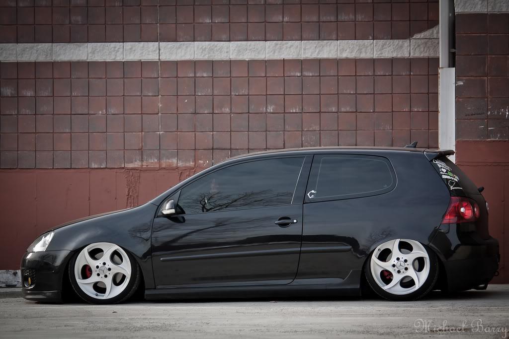

With a half decent stretch im pretty sure you'l get alphards on no bother. I'l tell you when i get mine on in a few weeks  :smiley:
Dude... You gotta tell me the specs of wheels. The drop and how the hell I can get me some lol
And pics and more pics!!

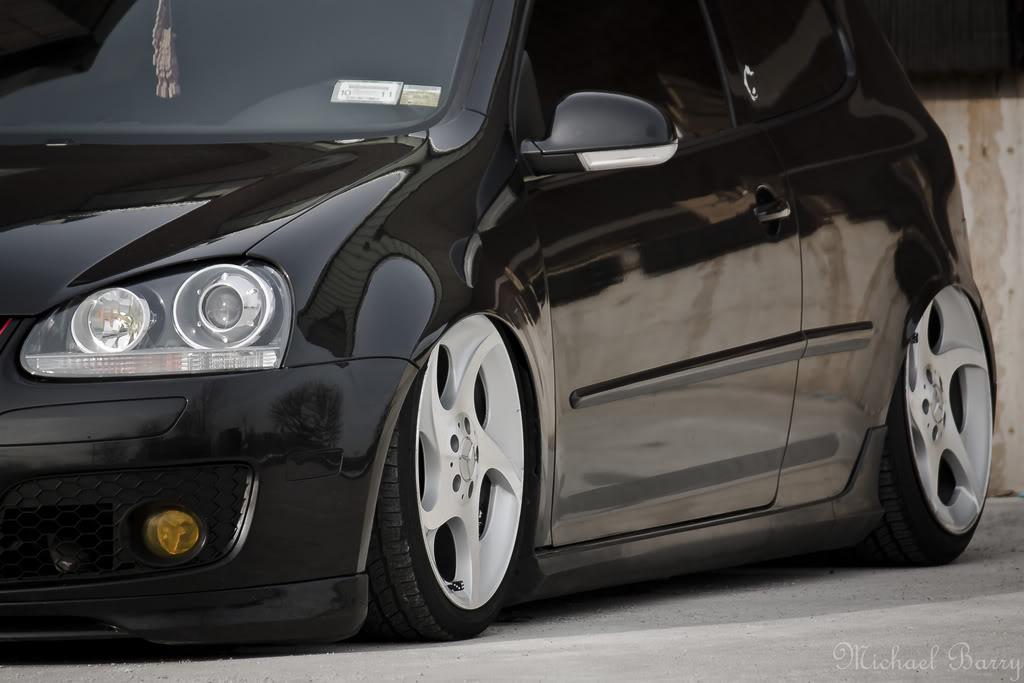

have you had to do any arch work mate?
cant believe the yanks have so many sets on theirs and dont seem to have that much agg...or are they keeping the amount of work needed to get fitment a bit quiet??
am sooo jealous lol... but keep thinking i might need coils if i,m gonna put these on-they def look better when its dropped low!
like dis...
matsu

Those all look the business, but even with coils you will struggle to get the same look as the pics.
Although have spoken to one guy on ED38 who can get some German H&R ultra lows or something that go as low as air, though they are about £1300,then a couple hundred to fit, and get  chassis notch etc. and you have to wind them right down which just isn't practical. FK and AP are some of the lowest ones you can get that I know of,without cutting springs,removing helpers, and all that dodgy stuff!

You can get reps that are Et44 and there like 600 for the set mate which isnt bad. The first pic you posted on the mk4 R32 ( deles) are the ones that i have sitting, bought them off him last week. Ive not done any arch work, not tried yet. Cars still sitting standard but i have brakes, coils, the wheels and loads more bits to get on once the weathers a bit better. Will let you know when i get them on though mate.

Alphards apparently are quite easy to fit, bit of arch rolling on the front, camber on the back to tuck the tyre in, should be quite easy I reckon with the right tyres,
 if your not going to lower it lots a 9.5 may look naff, you need it low to pull the look off in my opinion
