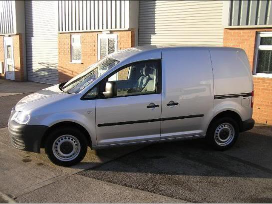

Now buying a MK3 Caddy isn't as straight forward as you think as i found out trawling the caddy forums. Three choices 140ps 6speed 2.0 TDI, 104ps 1.9 TDI 5speed or the 85ps 1.9 SDI the first is the most saught after then the 104ps and then the rather slow SDI. Up here in Scotland there are lots of the SDI's about due to there reliability and there low running costs so Co's favour them, I quickly ruled them out as they are just to slow if it even looks at a hill its clams up. So i went about looking for a 104ps model within my budget looking for elec windows, heated mirrors of poss low mileage and full serv history. problem number one vans are mostly high mileage or in poor condition so this scaled my search down to 2 vans within 200miles of my house lol. I wont bore you with the first one that was meant to be mint. So I ended up buying a 1 owner 56 Plate Reflec Silver 104ps C20 with 52k on the clock owned by a small engine rebuild company soon as I saw it you could tell it was well looked after paintwork was in fantastic condition with just a couple of stone chips, seats were as new as they had covers fitted from new. Full serv history and regular oil changes. Heres some pics

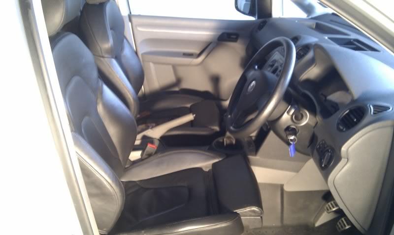

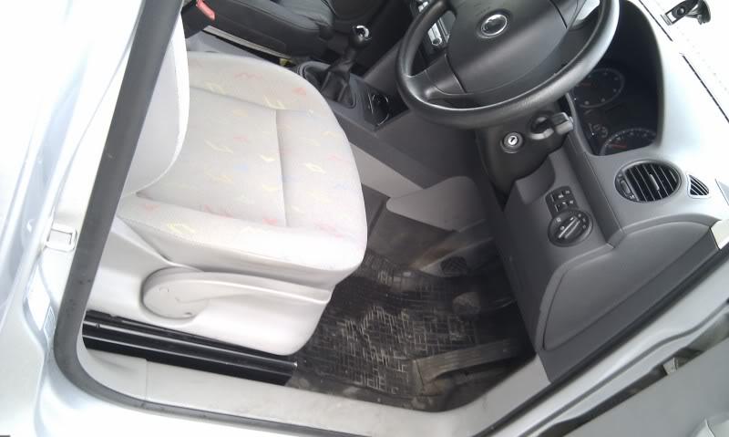

Now as this van is to be used for my business for which I attend shows I wanted it to have a few extras as the edition30 was always a good talking point and we always made it part of our stand so modding the van was a logical step. With vans though you are very limited to what you can do fortunately the Caddy shares a few things with the Mk5 Golf and the Vw touran a popular mod is a seat upgrade with the mk5 gti set up bolting right in I prev owned a gti cloth interior but sold it to Matt Poss on here :happy2: scouring ebay though I found an Audi A5 Leather front seats asking price £250 in the next town to me only 10mins away Happy days so i went to visit them and as they had been on the bay for a while the guy wanted rid so a deal was struck for 200 :smiley:
Fitting them involved a drill to the seat bases and chopping of two lugs on the base of the seats. Fitted here
These have electric lumbar support and are possibly heated so I need to figure out how to wire up the seats, any advice pm me :happy2:

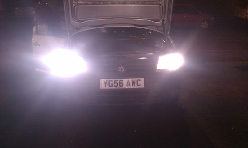

Next as with all cars it was a quick change of the headlight bulbs to some from powerbulbs, L/H side is the new bulb.

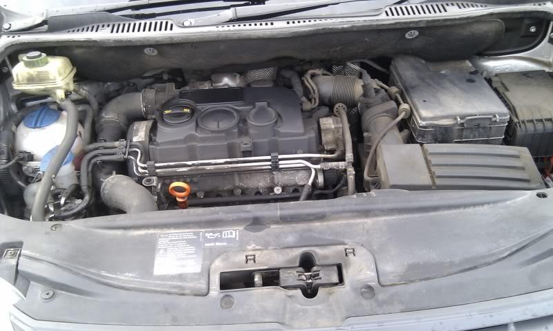

A wee clean of the engine bay as it had been done ever lol.

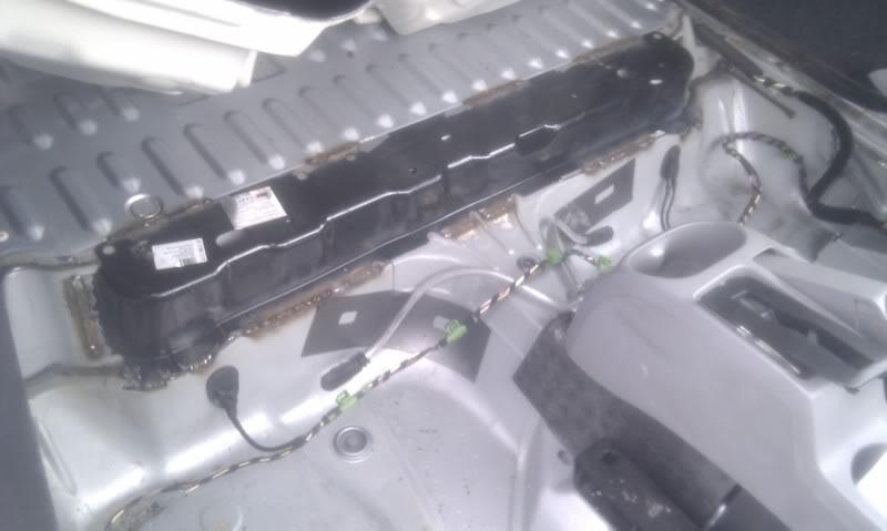

 :happy2: Heres the attachments under the seat, seats have airbags so one for that, they also have electric lumbar controls.

Looking good Keith  :happy2:
Let me know a bit about the heated seats and I may be able to help you out  :drinking:
The lumbar supports just need a + wire, as for the airbag plug you just need this:

Keith the yellow one will be for the airbags for sure.
Could you do a better picture of each connector with the wires showing? or just list the colours?
Do you know what year of A5 they were from?
Yellow connector has Brown,  Blue, Black
Red connector has Red/Black , Brown
Black Connector has Red/Black , Green/Blue, Green, Brown
Green connector has Red/White, Brown, Black/White
I will get some pics if req. :happy2:

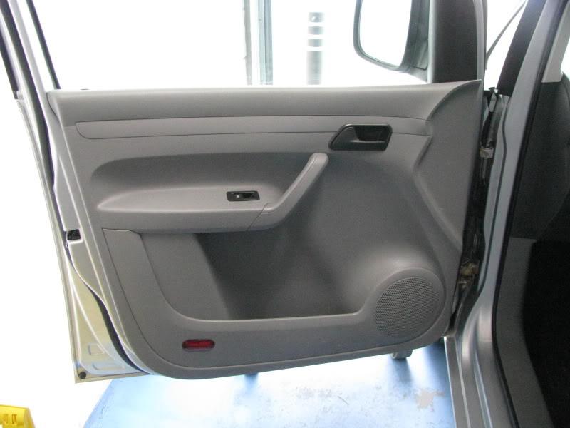

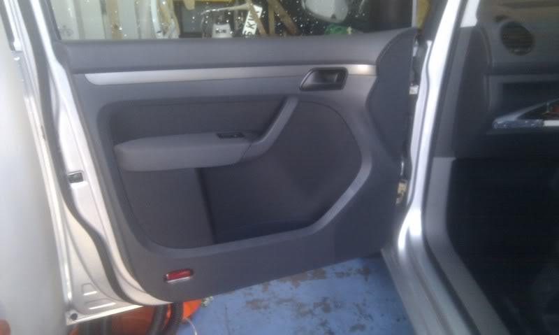

First up as you can sort of see in the previous pics the caddy's door cards are plain grey plastic and hard wearing so a popular mod and one which is hard to come by is the touran door cards :smiley: they need a wee bit of cutting but well worth it. Heres the new ones fitted took months to get them
Old
And new touran ones

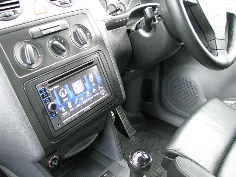

after that it was time to bin the RCD300 and get something better so i got a good deal on a kenwood ddx4028BT good unit with bluetooth, dvd, ipod.

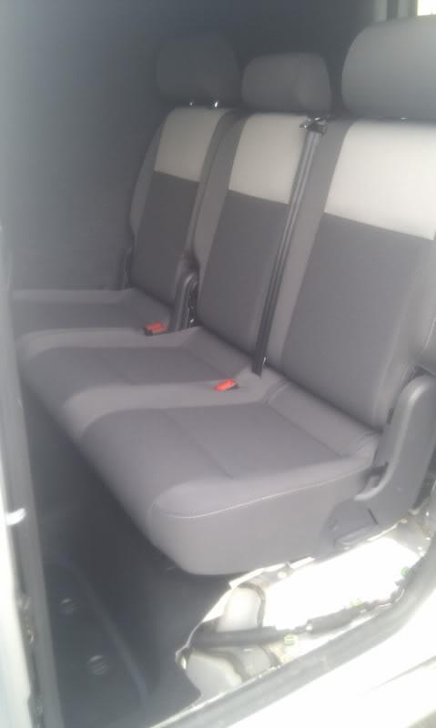

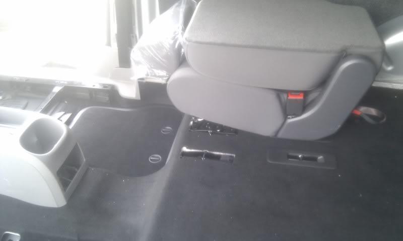

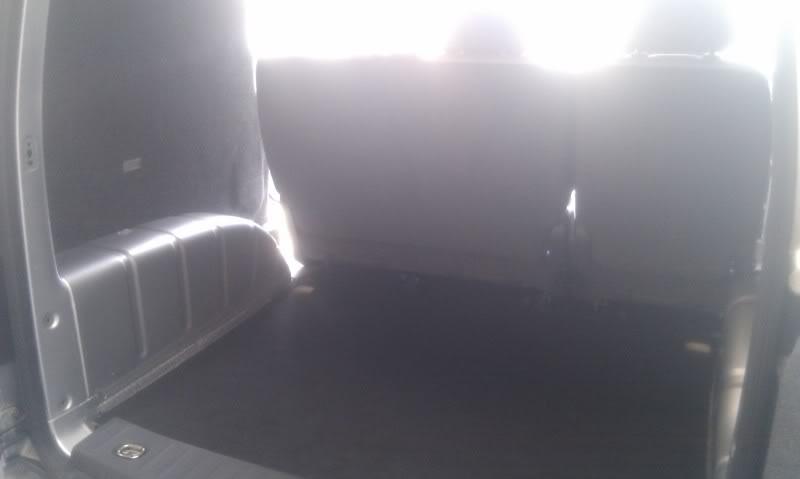

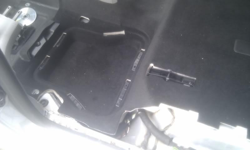

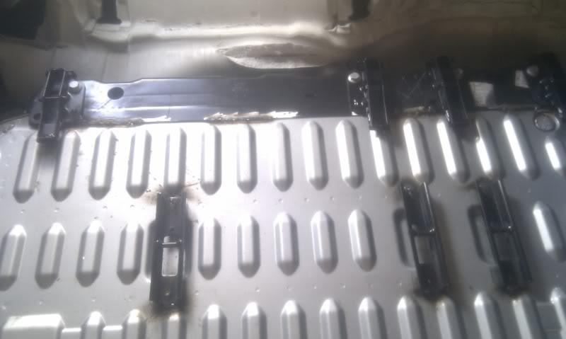

Now for the big stuff, I needed to have to get another car as well as run the van which would have been dear so I thought about retro fitting seats. I went to VW who came back with a silly price so i set about getting the parts myself best place to start ebay :wink: htere were two options a kit for £800 which was just the rear seat and another from a co who do disability conversions on the caddy maxi so i got in touch with them and they could do 95% of the stuff for £400 result then the guy said they were up my way doing a demo and could deliver for free :notworthy: nice!
I will keep this short but you remove the bulkhead and then have to cut out a floor panel reveal the foot recees for the seats, weld a new seat mounting and some floor anchors. Bearing in mind I have never done this before I am well chuffed with it.

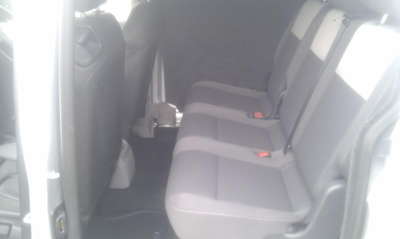

got some under floor storage and the caddy maxi carpets as well.
seats are  two seater and a single

« Reply #14 on: January 22, 2012, 12:30:18 am »
seats come fold down and also can be removed in less than 5 mins but even with the seats in its still got room
