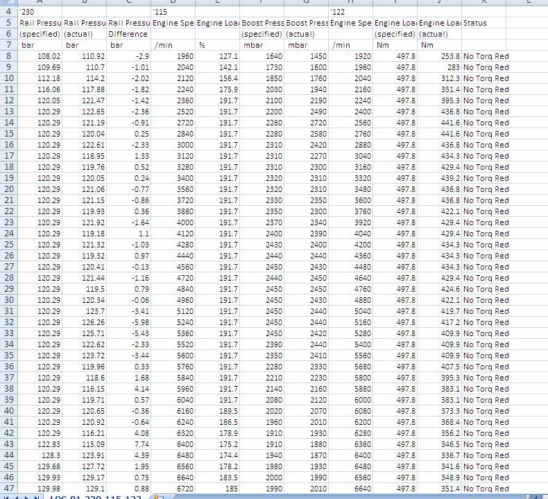

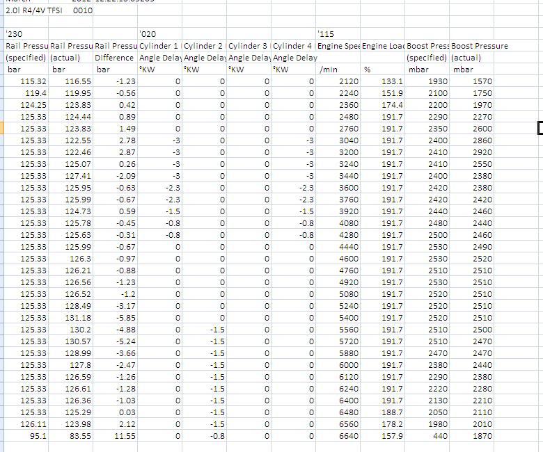

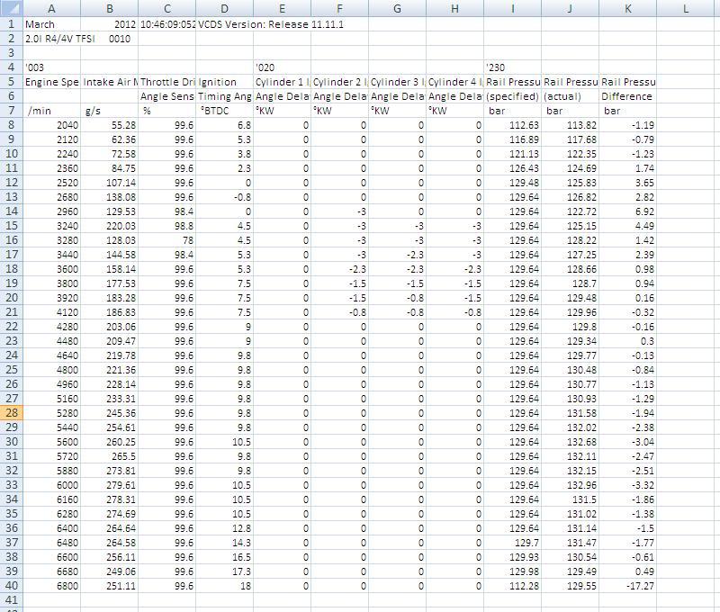

did some datalogging again, looks like this new map doesnt follow the same rules as all the other maps I've had :ashamed: :ashamed:
seems like it does change requested rail pressure dependant on unknown variables :stupid:
3 different rail pressures on 3 sets of logs so far
