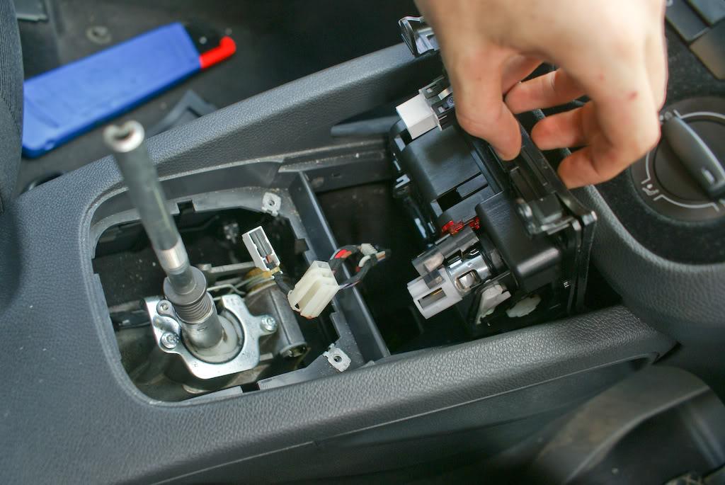

top man, got it off and on the underside of the socket there's a 3pin plug connected to it (and a little green thing clipped to the side) does this sound normal?
Offline golftdi04
  • Posts: 15
Re: Front cigarette lighter socket not working
« Reply #10 on: March 06, 2011, 09:28:05 pm »
looks identical to this (but it's connected and the black thing piggybacking off the bottom of the socket, is green on mine...doubt it makes any odds.)
