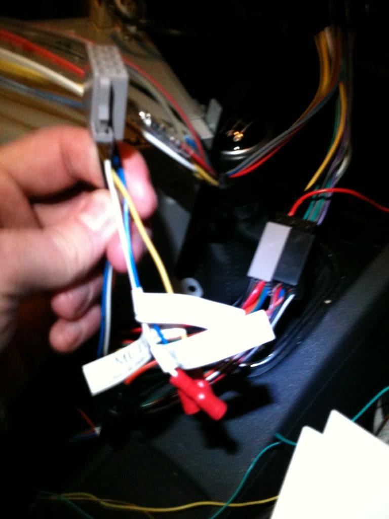

I got round to checking my Head unit/Parrot set up and it does pause the music but the volume doesn't work. I assume somethings not quite right... :confused:
Black GTI, DSG, Cruise control, MFD2,  Leather, MFSW with paddles, Parrot kit, Xenons, CD Changer, Armrest, Come home lighting/puddle lights, mod list in glovebox waiting for some cash and sunny weather....

The volume doesnt work on the HU or the Parrot?
Offline alexperkins
  • -Receive: 99
  • Posts: 2122
Re: Parrot Ck3000 evolution Volume issue

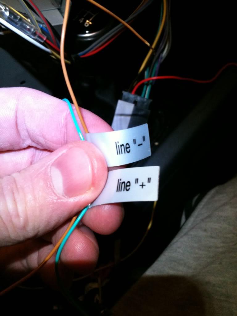

« Reply #23 on: March 30, 2011, 01:05:18 pm »
Looking at the pic
Line- would be Tel R-
Yellow Mute would be Tel Mute
Line+ would be Tel R+
Parrots are just messy for integration - youd have to unplug both ISO adapters from that quadlock loom and just use those three on the new connector i mentioned above
Redev- on yours, they have connected the mute, but left the audio going through the ISO blocks rather than via the HU on the proper terminals

That sounds like it could be it as the volume on the parrot works but the output from the head unit/speakers remains the same while in call (although the display on the headunit shows the volume going up and down) when I adjust the volume switch/buttons on the steering wheel...
Is it just a case of switching one cable then?
I'm just trying to get an idea so when I go back to the installer I can tell them what exactly they need to do..cheers Alex
Offline alexperkins
  • -Receive: 99
  • Posts: 2122
« Reply #25 on: March 30, 2011, 02:20:20 pm »
Two possibly three cables
It needs to be put into the 12pin TEL housing on the pins highlighted in my earlier post.
