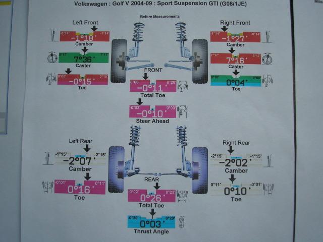

On a sadder note, Failed MOT yesterday on a fractured rear beam !!
No idea how it happened could have even been there prior to purchase but wasnt spotted on last years MOT.
All sorted now and rear beam replaced, BIG dent in my modding funds (for now) but safety is the priority  :happy2:
Offline stevw1
  • Posts: 262
Re: Stevw1 2012 Spec
« Reply #51 on: March 21, 2012, 04:39:57 pm »

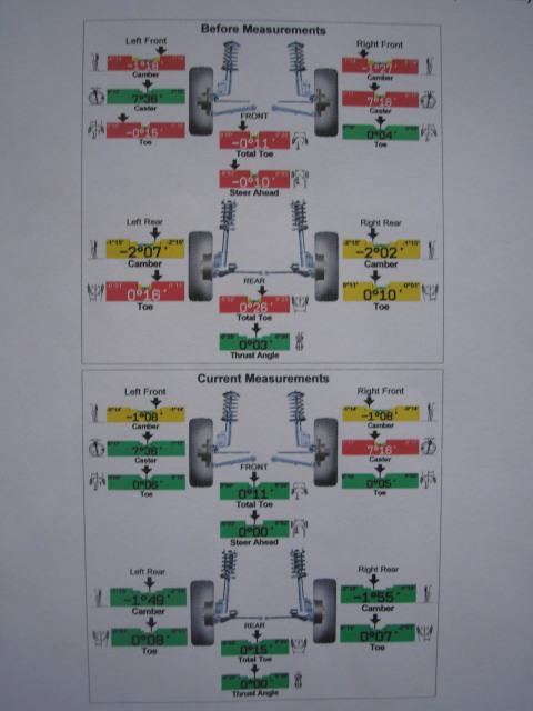

Post MOT and new rear beam fitted, decided to take it in for 4 wheel allignment.
Took my car along to Drury Lane Service Centre for 4 wheel alignment as it was thrown up on the MOT that my front wheels were in a "V" formation.
First reading showed that all 4 wheels were outside of their recommended perameters.
Exaggerated view
So an hour and a half later and a good few adjustments. The before and after shot
Everything all back to within VWs settings, steering certainly feels better and more responsive and with the new rear beam now in place rear end is not so noisy either.
Big THANKS to the guys at http://www.drurylaneservices.com/geometry-alignment/ very friendly and professional, well recommended [Y]
