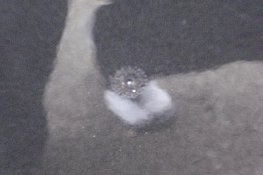

Chased VW dealer and they now want "more images", basically they have done nothing  :fighting:
Here are my images, 1st is drivers side second passenger, both in same location.
Abridge VW suggest these are stone chip damage (car is a 2007), any thoughts as to whether this is likely?

« Reply #8 on: April 28, 2011, 09:59:23 pm »
2nd pic does look like a stone impact imo, 1st pic is difficult to work out where the photo is aimed at?
Right in the middle of the pic for the 1st one, just above the side skirt.
Is it normal for a stone chip to rust like that on a can thats 4 years old?

« Reply #10 on: April 28, 2011, 10:10:57 pm »
If the impact is deep enough, and not been touched up to prevent rust appearing, then yes its possible...
But you are not the only one to complain with rust issues, which have been pointed at the inner arch liner rubbing away at the underside of the wing, rubbing away the paint . Looks like a design fault from what ive read here and other forums.
