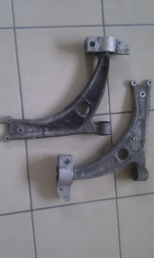

These are what I am hoping to fit:
I am after a reduction in unsprung weight so the negative camber idea was a added side effect to me. I assume these are just a case of unbolting the orignals and bolting these on. If there is no difference in length and camber then should I really need the alignment checked?
I would say no, but if in doubt then measure the one you take off with one of the S3. As you are using the S3 rear mount there's no need for the hydraulic press.  :happy2:

« Reply #9 on: April 19, 2011, 07:39:52 pm »
Yes you would be supprised how much changing like for like can put it out. Even just unbolting everything and putting it all back together can knock it out a touch.
