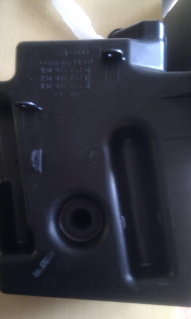

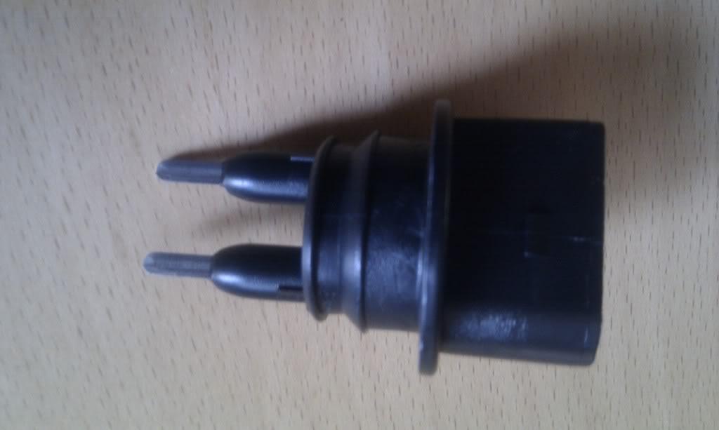

Once you have the loom you will need a switch (sensor) the grommit and either the larger bottle with the hole in or you can drill a hole in your existing bottle. I would recommend buying the larger one.
Part no's are:
1K0 955 453 s - Bottle
7M0 919 376 - switch (sensor)
7MO 919 382 - washer (grommit)
Like this:
and the larger bottle (now black)
Remember all this will need wiring in and coding. :happy2:
