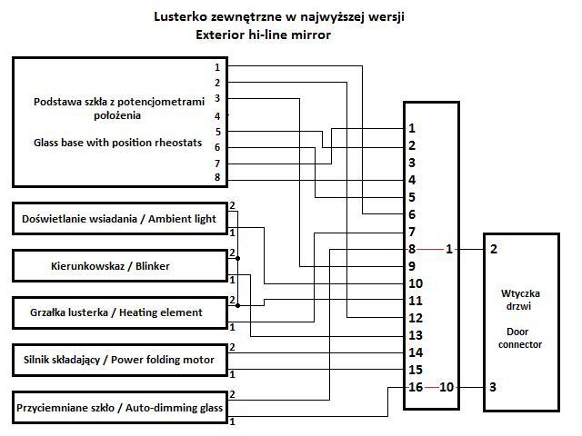

hello just after some help please
ive relised after like 1 year now, that when i bought my mirrors with puddles lights, it had the expensive auto dim glass in the driver side  :jumpmove:
now ive opened up the mirror and the wiring is in place, the two wires that are connected to mirror for the dim are black/green and black/grey
the black green wire goes to PIN 16
the black grey wires goes to PIN 8
now ive read the thread on vwvortex
http://forums.vwvortex.com/showthread.php?4796843-Exterior-auto-dimming-mirror
but im still confused on where i have to add wires to, do i have to add wires from connector to connector? or something else
ive pm darren just waiting on his reply
also not sure what to do  with this pic
thanks for any help!!

If you take the cover off in the drivers footwell you need to check the large connector and make sure that pins 2 + 3 are occupied if so then your auto dim should work???
If it doesn't work then you need to also check that the doors loom has the wiring in so check the 20pin plug that goes into the controller pins 1 + 10 are occupied??

thanks for that darren, im at work again  :fighting: lol, so ill have to check tonight again!
so if none of the wiring is there, does that mean ill have to add wires from the interior mirror?
thanks

Sure will mate but the wiring is on the passenger side and runs down the A piller

so it would PITA in to do then?  im pretty sure when i was workin on the car today the 20 pin connector had a wire in NO 1

if all the wires were they are supposed to be, what wires do i have to add? as im still confused lol

just to confirm darren, ive had a look at the 20pin connector that plugs into the drivers door module pin 1 and 10 are occupied
green and white, i had a quick check as i left my door card off before i went to work, will check the footwell connector tom aas its chucking it down and its dark,

Have you checked the actual operation of the dimming mirrors? by putting your hand over the front of the interior mirror and shinning a light into the sensor at the front of the mirror? All the mirrors should dim?

i thought that if the interior mirror dims, the the mirror should dim also?
when the interior mirror dims the wing mirror doesnt. so not sure why its not working?
prob have to arrange to come and see you and hopefully youll be able to sus it out why its not working.
