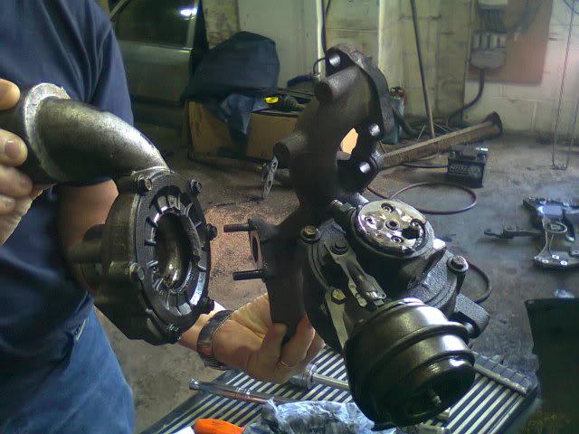

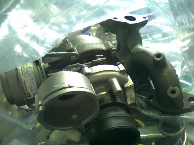

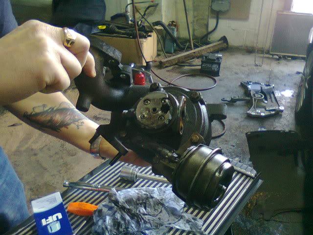

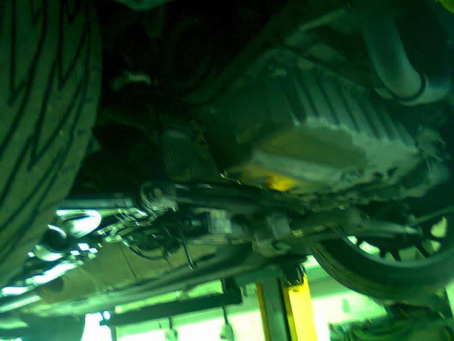

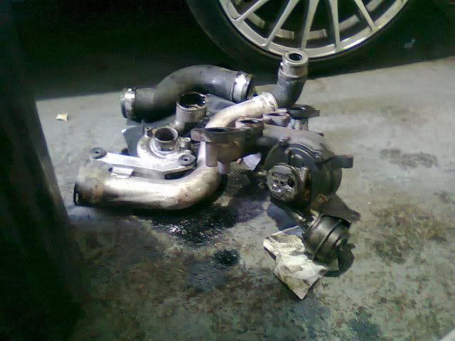

I went to see the car today but Steve wasn't there so Ian took me through what was happening and showed me the affected parts that have been replaced.
Any way the turbo is here I'm not sure of the specifics but it did say Garrett on it
The car on the ramp with the steering rack cradle and rack dropped,
Nice new Hybrid turbo
And something you don't see often, plus the cradle and intercooler in the back ground.
Some parts on the floor with the damaged turbo
Not sure when it will be done cos they are very busy at the moment so maybe late next week?
