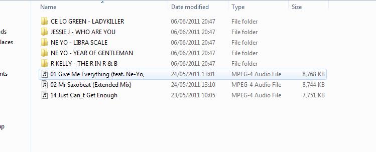

Can't get the sd card to be recognised or read on the unit. any ideas?

How big is the card?

« Reply #55 on: June 06, 2011, 08:22:24 pm »
tried a 256mb and a 1gb ! It seems to recognise it when you push it into the slot but then nothing happens and i then cannot see the sd card as a option on the top of the screen next to the cd heading.

« Reply #56 on: June 06, 2011, 08:41:56 pm »
Check they are FAT32 formatted

« Reply #57 on: June 06, 2011, 09:02:42 pm »
Yes the Cards are FAT32........when i put the card in it says......."Loading data........Please wait" ...then nothing happens

« Reply #58 on: June 06, 2011, 09:16:18 pm »
How have you structured the folders and what file format are you using?

« Reply #59 on: June 06, 2011, 09:29:25 pm »
This is how they appear on the card...........don't really know what you mean by "how are my folders structured" or what file format i am using,,,, do you means what type of musics files? they are mpeg 4 audio files
