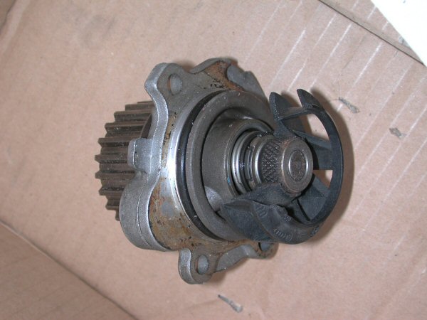

If at any time you go into the cam belt area, for peace of mind i always changed the Water pump.  Saves having to take it all apart again at a later date, and pay twice for the privilege.
I had a Water pump fail on my MK4, it wasn't leaking, only symptom was the car overheating regularly.  The Impellor is plastic, and due to the multiple hot/cold cycles, becomes very brittle, and starts to break up, once  a small piece breaks off, it accelerates the whole process due to the impellor now being out of balance.
I replaced it with an after-market (German/Swedish) brass impellor pump, and vowed to always replace if having ther Cam belt replaced.
For the sake of a few £ on top of the bill, it is a no brainer for peace of mind, but as always your choice.
A few pics of the sort of damage I found.  (not my pics)
